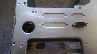

dormcat wrote on 2023-06-30, 19:13:
Looks like the keyboard DIN-5 connector is too far from the back plate of the case. I suspect the bottom of the bracket hits the […]
cydvog wrote on 2023-06-30, 15:25:
No its not, see pic
cydvog wrote on 2023-06-30, 17:15:
Yes motherboard has a tray and its fit correct
Looks like the keyboard DIN-5 connector is too far from the back plate of the case. I suspect the bottom of the bracket hits the floor plate (the yellow line) instead of the slot opening.
More importantly, why does it look like the corner motherboard screw hole is not aligned to a screw mount point and why is there no screw?

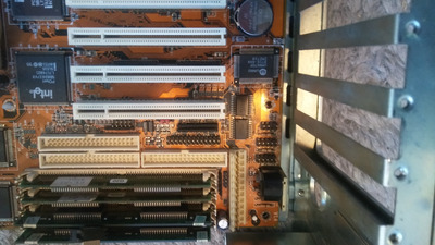

There is another thing that I have noticed with that picture, apparently it isn't a Slot 1 motherboard and lacks the ATX connector that was displayed in the first picture.
Perhaps the OP is testing with a different motherboard to see if everything can fit on the AT computer case without issues?
Reply 22 of 39, by dormcat
Gmlb256 wrote on 2023-06-30, 21:14:
OldWingCommander wrote on 2023-06-30, 20:50:
There is another thing that I have noticed with the second picture, apparently it isn't a Slot 1 motherboard and lacks the ATX connector that was displayed in the first picture.
Perhaps the OP is testing with a different motherboard to see if it can fit on the AT computer case without issues?
I was typing and you beat me to it. 😅 The #1 post had a Slot 1 Pentium 2, both AT and ATX connectors, and SDRAM; the #13 post had EDO RAM and AT only.

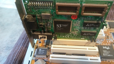

In first picture the card is NOT properly seated in the PCI slot, the back is not fully down as others mentioned. Looking close at the slot it is obvious, see picture below.
Also: rare but I have stumbled on a few brackets that are about 1/16" or so above the case back when properly seated, for those I barely bend the Tang down so it fits a bit closer....

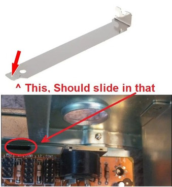

Reply 26 of 39, by weedeewee
the bottom of the card plate should slide into the slit of the mainboardcarrier.
    37.24 KiB
    985 views
    this slides into that.
Do not ask Why !

the standoffs you are using to support your mainboard are too short.
put mainboard back in case and take photo like in this post. Re: Pci cards not fit completely
keyboard connector should be clearly visible !

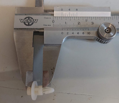

Reply 36 of 39, by weedeewee
Measure the standoffs Re: Pci cards not fit completely
like this
    77.1 KiB
    918 views
    standoff measurement 6.5mm
Do not ask Why !
Reply 38 of 39, by weedeewee
mine are 6.5mm
