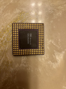

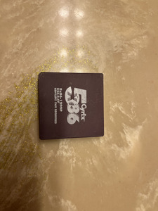

What's the printing on the back of your CPU?

I already have the 5x86 configured using Peter Moss' 5x86 utility. Attached are front and back images of the CPU.

    Cyrix 5x86-120GP Back

    Cyrix 5x86-120GP Front
