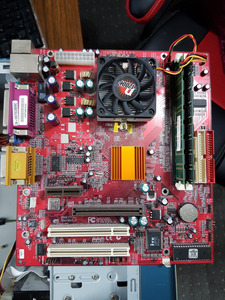

I'm looking for 030513S.rom check sum:BAEFh (what kind of checksum is that?)

This is the bios string:
62-1106-001131-00101111-071595-SiS730S$M810LR7Release 11/06/2002
According to the website, it should be: 021106S.rom and check sum should be 74FEh
I intend to change the CPU fan, but it has some sort of RPM detection, and if doesn't reach a certain threshold (a really high one), it automatically shuts down.
According to the changelog, this was fixed in version 030310S.

I looked it up on theretroweb but I couldn't find this particular BIOS (matching string, date). I also found that there are other bios for different PCChips motherboards that share the same release dates, so it wouldn't be wise to put a random BIOS unless we can find a way to confirm it has the right checksum.
Sample image of the board, taken from a post by forum user PTherapist.

The M810L has a Duron 900 D900AUT1B, running at 950MHz, with an overclocked FSB (210MT/s) and there are no settings regarding memory timings or CPU voltage/clock tweaking.
What really sets the M810 apart is that they have an universal AGP and that the chipset SiS 730S supports DDMA.
