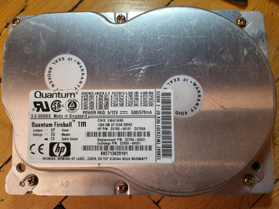

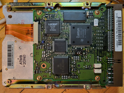

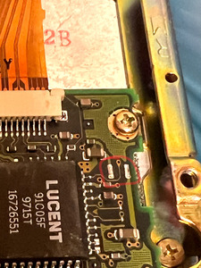

When trying to start this hard drive, it spins up but can't even start a selftest. Upon visual inspection, I found that one rather large element was knocked down in (as far as I understand) the power circuit next to the head cable connector and the LUCENT 91CO5F chip.
I have already tried simple things: changing the master-slave settings, cleaning the contacts, reconnecting the head and motor cable - nothing helped. It really needs this component to work.

Reply 3 of 6, by shevalier
rasz_pl wrote on 2023-07-03, 12:33:
blue fuse?
ferrite core inductor.
ferrite bead will good enough, or wire too
Aopen MX3S, PIII-S Tualatin 1133, Radeon 9800Pro@XT BIOS, Diamond monster sound MX300
JetWay K8T8AS, Athlon DH-E6 3000+, Radeon HD2600Pro AGP, Audigy 2 Value
Reply 4 of 6, by crapasanya
shevalier wrote on 2023-07-03, 15:01:
blue fuse?
Nexxen wrote on 2023-07-03, 12:25:
Probably a big filter.
Have you measured the two leads? Is there V at one of them?
https://cdn.shopify.com/s/files/1/1267/5579/products/Quantum_1280AT_2_grande.jpg?v=1527227921 https://wiki.preterhuman.net/image […]
blue fuse?
Thank you so much for the replies, I will try to measure this and if there is voltage at one of the ends, close the pads with tweezers. I will do this as soon as I get home.
Reply 5 of 6, by pentiumspeed
Inductor. Just power path. Any inductors even the solid one is fine that large, the one that nearly reads zero ohms can be good substitute.
Cheers,
Great Northern aka Canada.
Reply 6 of 6, by crapasanya
So yesterday I tried shorting the pads with tweezers and what I got was that the motor started to work differently, a little louder, but no selftest, just a quiet even "ticking" of the head for about 5 seconds (I guess it tries to find a track, but can't?), and then the motor would stop and the busy LED on the hard drive itself would flash. And yes, at one pad there is 5v, at the other a little more than 1, I also measured the second exactly the same element on the board and it is measured as 0 ohms. Tomorrow I will try it on a couple of other computers as I have a lot of work today.
