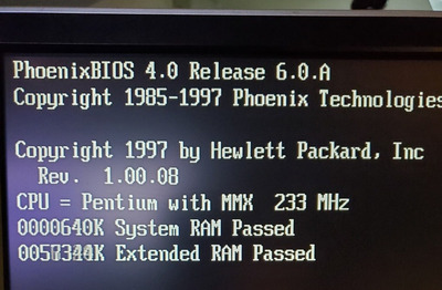

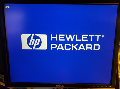

Hello everyone,
I really like this board (ASUS TX97-XV), but I am highly annoyed by the HP splash screen and HP branding during POST. Specifically, I'm looking for a BIOS that doesn't have the plash screen and a reference to HP. The Retro Web offers, what appears to be, the retail version, but the board wont POST with it installed. Does anyone have a version of this BIOS that doesn't have the HP branding during POST?
Is it a simple matter to have these things removed? I loaded the BIOS image with an LAQIYA TL866Ⅱ Plus but I couldn't see any reference to HP.
I have it in the "sell on eBay" pile, but every time I do I think about how awesome this board is and I can't bring my self to do it.
Thoughts or suggestions?

Hi pico1180,
Because there is an HP Phoenix BIOS on the board now, any Asus flash tool will be unable to flash the Asus Award BIOS. So using a programmer like your TL866Ⅱ Plus is indeed the only way to get the retail BIOS from Asus on this TX97-XV board.
However HP is using a 256KB EEPROM on this board and the Asus retail BIOS is only 128KB. Therefore the Asus BIOS needs to be flashed in the top 1Mbit of the 2Mbit EEPROM, so from addresses 0x020000 to 0x03FFFF.
I have reports from other TX97-XV users that it works this way, using the latest 11/24/98-82430TX-TX97-XV_C-00 Rev. #401A0-0112xv-1 Award retail BIOS.
Another option is to take a 1Mbit EEPROM, like the SST29EE010, and program the Asus binary in there. This has the added benefit of enabling to use the Aflash tool for future 128KB BIOS updates, like my patched version. 😉
As you may know, these 1Mbit and 2Mbit EEPROMs both use the same 32-pin DIL package and are pin compatible.

Reply 5 of 6, by pico1180
Thank you so much for this help! I couldn't figure out how to speicify the flash address in the 2MB chip, and based off your post it really seemed like a less desirable way to go. So I ordered some SST29EE010's from China and used the modified bios you provided. It appears to work wonderfully. Installed Win 98 on a 16GB SSD with zero issues. I have a 128GB SSD I may try in the future, but larger disk sizes wasn't really was just an added benefit. I just really wanted to get rid of the HP branding.
Again, thank you so much for this. I can now move this project off my bench and into the completed category 😁
