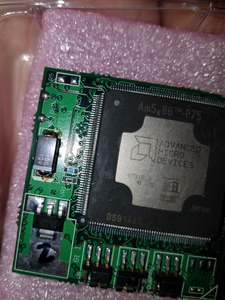

So I got one of these things for a screaming deal (assuming it works) and I was wondering if anyone was familiar with this variant of the interposer. I know some of them had unpopulated solder points for a 5 volt fan, but I don't see anything obvious on this one. Any ideas?

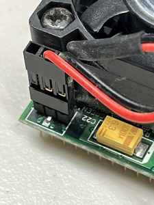

Mine has a 3 pin header near C22, but the fan only takes two of the three pins. It has a 1998 date on the bottom.
Maybe you could get out the multimeter and see if one of those pinless vias labeled "R5" goes to +5 and the other to ground?

Ok, so got a better measurement of continuity:
Left pad of R5: Pin 3 of VR1, be 5 volts
Right Pad of R5 : A23 or A24
Upper Solder Pad: Pin 1 of VR1, Ground of VR1 used for adjusting Voltage
Lower Solder Pad: Ground
So it'd have to be a pigtail I solder in. Not sure if I really want to do that TBH, I'll have to mull over it.

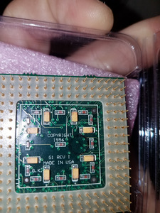

Mine comes with some cut wires that were soldered directly to the C22 capacitor
Evergreen part G1 rev 1, copyright 1996, the datecode on the AMD chip is from 1997.
