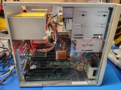

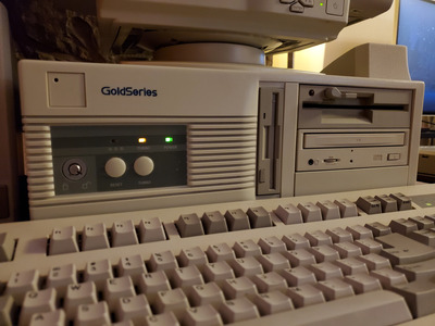

CPU: i486DX-33
MB: Soyo 025L2 w/ 256k cache
RAM: 8 MB 72-pin
Disk Drives: 3.5" and 5.25" Floppy drives
CD Drive: Mitsumi 6x CD-ROM
Fixed Storage: 512 MB Sandisk CompactFlash + CF-IDE Adapter
Video Card: Tseng ET4000/WP32 VLB w/ 1 MB of RAM
Sound Cards: GoldLib, Primax Soundstorm, Yamaha Audician 32, AWE64, MPU401-AT + Yucatan FX wavetable
Controller Card: Data Technology DTC2278E VLB EIDE controller

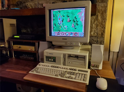

This system went through a number of configurations before eventually settling on its current build.
It started as a 486DX2-66. In using it, I consistently either wanted a faster system for 3D shooters or a slower system for early 90s adventure games. Since I already have multiple Pentium systems that can handle the former, I decided to downgrade this system to a 486DX-33 with a focus on adventure, RPG, and strategy games from 1990 to 1994.
Given the time period my biggest focus was on sound options. I tested various dual and even triple sound card setups. Eventually decided went for a full 5 sound card setup, similar to my previous 386 DX-40 build. Everything was built around accommodating the Goldlib (Adlib Gold clone), which meant using PnP cards with configurable FM port addresses such as the Yamaha Audician 32 and AWE64. The AWE64 is probably overkill for a system focused on the early 90s, but some games that use SB16 or AWE32 can be played on this setup. Alternatively, I may try swapping it for a Pro Audio Spectrum in the future.
For games that use MT-32 music, I have both an external MT-32 and Roland CM-32L, the latter for any games that take advantage of the extra sounds in the CM modules.
Performance-wise, I find the 33 MHz quite good for a lot of games of the period. At 66MHz the DX2 processor was too fast for some games and caused issues. For example, Rise of the Dragon and The Adventures of Willy Beamish had MT-32 initialization and playback issues. But with the 33MHz chip they work perfectly. Warcraft also runs nicely at this speed.

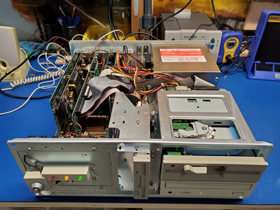

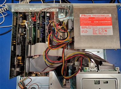

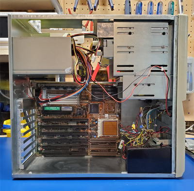

Sadly, the system has died. 🙁
I was reworking the sound card setup to see if I could incorporate a GoldLib into it. After a bunch of hardware swapping, I landed on a setup with the GUS Extreme, Orpheus II LT and the GoldLib.
Unfortunately during testing, the system locked up and won't POST anymore.
Did some quick tests on the PSU; voltages seem good. Tried swapping out components (CPU, I/O cards, etc.), but that didn't fix anything.
At this point I figure something on the motherboard went. I'll need to troubleshoot it to see if it's repairable, or maybe just rebuild with a new MB.
edited to add:
Re-testing the board itself and the motherboard is still working. I suspect the issue may have been RAM, as the RAM used in this board failed to POST on another motherboard I tested it with.

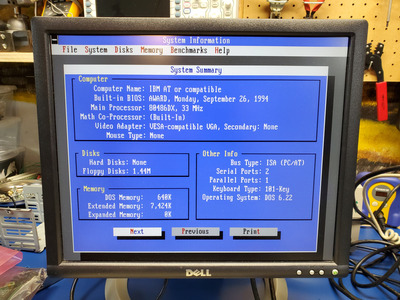

Update on the progress of rebuilding this system.
I decided to try out a Soyo 025L2 motherboard as a replacement for the prior board. One thing I never liked about the prior board was the placement of the power connectors blocked the top expansion slot, whereas the Soyo board doesn't have that issue.
801.37 KiB
2727 views
I did run into some issues getting it initially getting the board running. Turns out it's picky about which memory will work with it, which resulted in all sorts of strange POST issues including misidentified CPU types. It did work with a single 72-pin 8MB stick.
870.41 KiB
2727 views

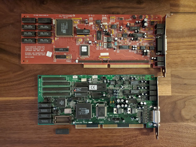

Next up is to figure out the sound card options. At minimum I want a GoldLib and GUS in this build, so everything else is built around that.
One card I'm debating over is the AWE64. It would give SB16 and AWE32 support, but for the 486DX-33 era not sure if it's that necessary.

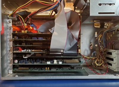

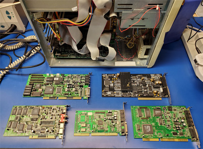

Got all the sounds cards physically installed. Had to work around some limitations based on the physical board layout (CPU & heatsink) and ribbon cables.
755.84 KiB
2635 views
Swapped the SCC-1 for a Roland MPU-401AT in order to fit everything.
897.37 KiB
2635 views
Now it's just a matter of figuring out all the hardware settings to make all this work.

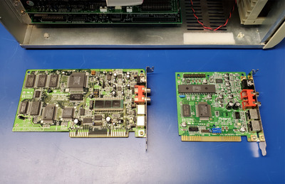

Couple updates on this build.

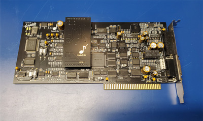

687.16 KiB
2446 views
First, the Goldlib stopped working. After a day of troubleshooting, it appears the EEPROM data was corrupted. The port address had been set to 80 and the system would no longer recognize the card. Fortunately, changing to dual port mode allowed it to be recognized and I was able to reset the settings.
After a bunch more testing, it seems to be working fine now. I'm still not sure what caused it, but with the number of other cards I'm got crammed into this system, I'm not surprised something went wrong.

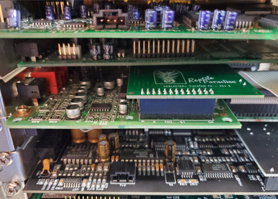

846.78 KiB
2446 views

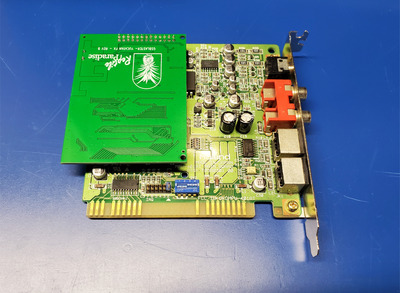

Also added a Yucutan FX daughterboard to the MPU401-AT. The limited physical clearance between cards has restricted my choice of wavetable daughterboards, but fortunately the Yucutan fits.
713.42 KiB
2446 views

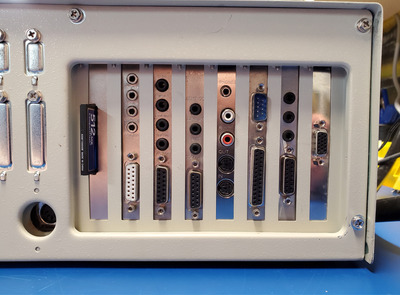

Reply 19 of 30, by Shponglefan
Transplanted this system from its original mini-tower case to a desktop case. Cable management is a bit of nightmare, but it's a 486DX-33 so not as concerned about overheating.
776.31 KiB
1596 views

Set it up on my retro desk with Yamaha YST-M10 speakers + MSW10 subwoofer, and a 17" Sony Trinitron monitor. For external modules, I'm using an MT-32 and CM-32L.
