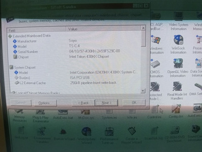

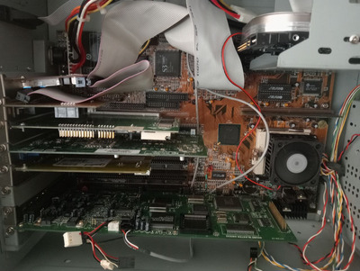

I Have a Soyo TS-C-4 mainboard, currently running a Pentium 233 MMX
Because i already have a couple of Socket 7 systems running on Pentium CPU's and 1 Cyrix, i was thinking about changing this system to an AMK K6 233.
I did some google searches, but i can not find any information about this mainboard.
Does anyone know where to find this board with the jumper settings?

better photos may identify the board better , I only found 5TS2. there is also SY-5TS5 / SY-5TF / SY-5TH
You can check my 486 links there may help...
it seems to be a 5TS/TF after the print-screen SN/ Award bios code :5TS/TF

Reply 2 of 5, by PcBytes
It's a 5TS2, someone posted it here before:
Help ID a Soyo HX board please
Reply 4 of 5, by DOS Retro
The BIOS Post says its a TS-C-4....
But a quick look at that topic say itś the same board.... i only see one difference, and thats the extra heatsink under the CPU at my mainboard
Is it still right or...?
Im little confused now
Reply 5 of 5, by DOS Retro
I did the magic trick.
I put in the AMD and turned it on. It just found the CPU.
It started Windows ME, and there I checked Sandra and Aida if the voltages were correct.
VCore 3.2volt, I/O 3.3volt
Just as noted on the CPU itself.
It seems like everything is doing well.
Thanks all for the help!
