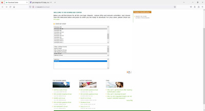

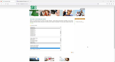

it's an older socket 462 board with universal agp slot, no ISA slots. got a 850mhz duron in it.
both hard drives inside were broken.
I plugged in a hard drive and installed win98se and used hardware info and it tells me:
sis 7305 + 85C503/5513/961 motherboard
onboard graphics: SiS300
network card: SiS900 Fast Ethernet 10/100 LAN
where do I got to get win98SE drivers for this?
I have no idea. 🤣

Reply 3 of 21, by Horun
Are you sure it isn't a SIS 735 chipset like the ECS K7S5A ? Is the SIS300 video onboard or a AGP card ?
I have the old w95/98/2k drivers CD from my ECS ... posted here: https://archive.org/details/ecs-k-7-s-5-a-cd-6-2-s-driver-cd (note: you cannot browse content for some reason)
it has the SIS735 chipset and SIS900 LAN drivers and SIS530/620/630/730 vid drivers plus a bunch of others.....
For the SIS300 you probably need this: https://us.driverscollection.com/?file_id=14164

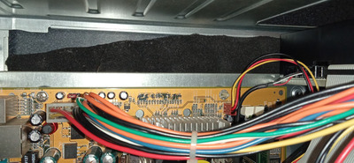

no model number on board, also there is a modem in the top slot thingy dunno what that is either.

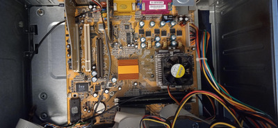

Reply 7 of 21, by kixs
You have probably noticed... there are at least 8 bad caps. This will make the board unstable.
You can also try some sys info program to identify the motherboard - AIDA32 for Windows or AIDA16, NSSI for DOS.

yeah i noticed the leaky caps, it still works though, i did use hwinfo already.

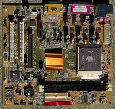

Reply 9 of 21, by Horun
Yeah Win98 is not that good at detecting proper, there is no SIS7305 chipset AFAIK but there is a 730, 733 and 735. The Hardware ID's would help a lot....
It look like a PCchips M810LMR v3 or close like this (some had full dip bios other had plcc), it has the SIS730 chipset:
https://theretroweb.com/motherboards/s/pcchip … r-3-0#downloads
    220.64 KiB
    1559 views
Reply 10 of 21, by Ydee
derpmochump wrote on 2023-07-16, 11:35:

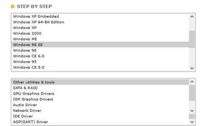

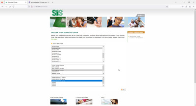

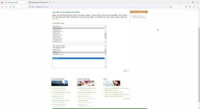

I think, it is not 7305, but 730s chipset - single chip solution from SiS. Drivers you can obtain here: http://w3.sis.com/download/
Member Horun was faster:)

thanks when i go to the sis site i don't see chipset driver download i see:
    25.72 KiB
    1503 views

Reply 19 of 21, by Ydee
derpmochump wrote on 2023-07-16, 19:01:
Ydee wrote on 2023-07-16, 18:28:
You need look better, all you need is here, look (you must choose driver and click on GO button):
    121.11 KiB
    1394 views
