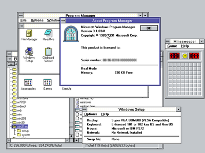

Edit: That's maybe a bit off-topic, but older Betas of Windows 3.1 did support Super VGA in Real-Mode.
The supplied drivers, do, I mean. If they don't do anything funny, a NEC V20 should be sufficient.
I'm just mentioning this, because it could provide a testbed for modifying the existing Super VGA drivers.
Windows 3.0 and 3.1 differ quite a bit at some point, especially drivers.
Having a Windows 3.1 prototype working on an XT could ease quite a few things. 🙂
Edit: The screenshot attached shows the older 800x600 16 driver supplied with Windows 3.1.
If you notice closely, it says it uses VBE.
It's not limited to known SVGA chipsets of its day, thus.
Maybe that's also true for the 256c types that shipped with WfW 3.11.
Maybe the 640x480c 256c driver can be modified to use 640x400 256c instead.
Either natively via Cirrus routines or by using VBE mode 100h.
