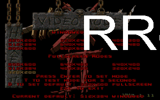

I have an error with your I76 profile still.
vHexen2 is fixed, but there's still the double 800x600 resolution in windowed mode
    23.93 KiB
    1977 views
    2.84 KiB
    1980 views
Reply 150 of 1558, by sharangad
BEEN_Nath_58 wrote on 2023-09-17, 10:19:
If you check the logs:
6:10:37.308 176 [0] VHexen2: reporting resolution 800x600x60
16:10:37.308 176 [0] Iteration 1
16:10:37.308 176 [0] VHexen2: reporting resolution 640x480x60
16:10:37.308 176 [0] Iteration 2
16:10:37.308 176 [0] VHexen2: reporting resolution 640x400x60
16:10:37.308 176 [0] Iteration 3
16:10:37.308 176 [0] VHexen2: reporting resolution 512x384x60
16:10:37.308 176 [0] Iteration 4
16:10:37.308 176 [0] VHexen2: reporting resolution 400x300x60
16:10:37.308 176 [0] Iteration 5
16:10:37.308 176 [0] VHexen2: reporting resolution 320x240x60
16:10:37.308 176 [0] Iteration 6
16:10:37.308 176 [0] VHexen2: reporting resolution 320x200x60
I'm not reporting the same resolution multiple times. There's a missing resolution at the bottom. It's not 1024x768. Quake 2 never went higher than 800x600 and I suspect vhexen II had the same limitation.
The question is what's missing?
[EDIT] Returning only 800x600 yields one fullscreen resolution and the windowed list is unchanged.
[EDIT2]
The extra 800x600 is the default resolution from data1\config.cfg:
vid_config_y "600"
vid_config_x "800"
Change that to :
vid_config_y "350"
vid_config_x "640"
and that'll appear after 800x600.
