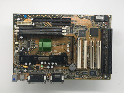

The company I work for has been holding onto all these late 1990s-2000s era servers in 4U cases since I started working there, and I have been asking about looking inside them over the years only to be declined each time (which I think is pretty crappy given that I'm part of a tiny tech crew of 3 there...*shrug*.). The company is getting ready to shut down the office and call junk people to empty the server room, so I asked again, and they finally reluctantly said okay for me to grab what I want.
I'll definitely have other topics to post about what I did grab, but what I want to post about today is about this motherboard that I am unable to properly identify.
The set of numbers below the motherboard led me to a Chaintech motherboards, which finally led me to the CT-6BTA2.
There is another almost identical-looking one , the Matsonic MS7070S.
I say "almost" because I see no vendor marking anywhere on this board. Also, one chipset is covered with a plastic brace above its heatsink, while the other has a "WARRANTY VOID IF REMOVED" sticker.
The gameport/parallel ports are not stamped with "E-CALL", I have Foxconn markings here.
The only other unique thing I noticed is the sticker on the BIOS chip, which might have a model number, but I am not too sure. Google did not bring up anything for me.
I have not tried turning this on. It has a 450mHz PII Deschutes (taken out for the pictures). Does anybody here have any ideas who "made" this motherboard?
Reply 2 of 17, by vzz
Okay, I really thought another vendor distributed this particular "clone". The Chaintech and Matsonic motherboards in the links are printed with "Chaintech" and "Matsonic" on them right next to the big AGP print, but mine isn't labeled any company anywhere.
Does the KE7942-3 Ver. 2.0 ring a bell to anybody here? That is what is printed on the BIOS chip sticker. Is this part of the KE-series of another company, or just something to do with the onboard audio 😀 I wish I was more familiar with motherboard brands of the 90's, I was just finishing elementary school when this particular one was made 🤣

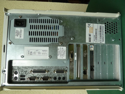

Reply 4 of 17, by DerBaum
This rear io panel on the unmarked version of the board says "OEM PC"...

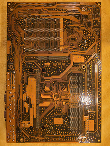

Reply 6 of 17, by PcBytes
My biggest giveaway for Chaintechs of this era is the dotted pattern throughout the board.
That, and in certain cases, the strange header used for USB on some of their socket 7 mobos.

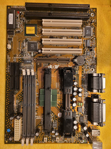

Reply 10 of 17, by PcBytes
giantclam wrote on 2023-09-20, 11:10:
...two things I noticed.... […]
...that wouldn't make sense on a 6BTA2 ...it does make sense on a 6ESA or 6LTM but this board is definitely 6BTA2 sku.... and one of the key differences here is chipset -- intel 440 BX/EX/LX ....
..which makes me look twice at this...
...errm.... since when would discovering a/the chipset part number, constitute voiding warranty? I could understand putting a sticker on the yamaha chip to obfuscate it's identity. but not that.... to me, it makes me think they're hiding something ... boot up linux and see what it finds (if you're attest to removing stickers =)
It is present on other 6BTA2 boards. Check this photo I found from a bay listing. M101 marking in the same spot, and also no CT/Matsonic markings, just like OP's board.
file.php?mode=view&id=174164
So to answer to the topic - OP, your board is a 6BTA2-H103N to be exact. The only things I can explain about the different tag instead of 6BTA2-H103N, is that the company that made the servers might have requested the specific text in place of the actual model.
Reply 11 of 17, by giantclam
PcBytes wrote on 2023-09-20, 11:20:
It is present on other 6BTA2 boards. Check this photo I found from a bay listing. M101 marking in the same spot, and also no CT/ […]
Good find... also has the same 'KE7942' id on BIOS sticker (likely the ODM) but earlier revision
Reply 12 of 17, by vzz
Oh thats really interesting! Thanks on the confirmation and that revision number as well! I definitely have never had a chance to look at a motherboard from that era in person before this one, so this is definitely great to know that this is indeed a Chaintech product.

PcBytes wrote on 2023-09-20, 08:35:
Those dotted line etchings actually look really cool. They all seem aligned to a different line of each bus. It probably makes probing the intel chips much, much easier.
Nice find! That example definitely clears up the exact model number of the motherboard. And we both suspect the same thing with the label on the BIOS chip. "ATX-AUDIO-2" itself could be how the server vendor marketed this board in their catalog/website/etc. Where I live, there used to be a place called TigerDirect, and I did check the archive of their website just in case this was one of their store brand motherboards, but I don't think it was them. I'm not sure who specifically sold servers down here back then. Finding the actual motherboard manufacturer, model number, and revision is good enough though.
