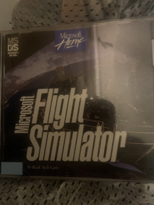

I just got a physical copy of Flight SIM for MS-DOS but I have a windows 10 PC. If anyone can help me try to get this MS-DOS game to run on my pc I would be VERY grateful.

Huh, isn't vDOS for textmode applications?
That appears to be Flight Simulator 5.1 which should work fine on DOSBox. You will need to mount the CD drive in DOSBox, then install it from the disk.

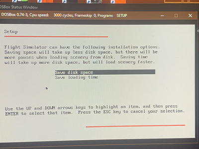

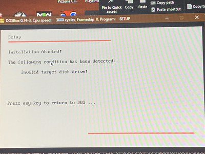

Every time I open setup it just says this exact thing

    I put “C:\FLIGHTSIM51”
Reply 11 of 25, by Disruptor
leileilol wrote on 2023-09-25, 03:48:
"FLIGHTSIM51" is a long name. DOS does not do names longer than 8 characters
Except volume labels. They can have 8+3 = 11 characters.
But C:\FLIGHTSIM51 won't work.

It’s always after I press of these two buttons, doesn’t matter which one.

    Just to confirm this is Flight Sim 5.1

@PixelLovesDos ~ I was able to recreate this error with dosbox in linux -- problem was I didn't have a local dir mounted as C:
https://www.dosbox.com/wiki/MOUNT
Going by your YT vid, that's what you're missing

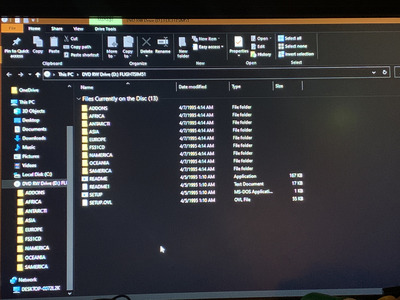

Not that’s not it, I was using D: because I’m using a cd-rom. And usually a cd-rom is in D:

    Here’s what’s in the cd-rom if needed.
