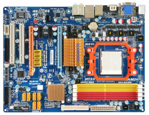

shevalier wrote on 2023-10-19, 07:10:
Well I see some mistakes. On yellow boards, capacitors with blue markings do not look good - only with red and black ones. On bl […]
On blue ones - everything except with green markings.
And everything is fine. 😀
Because everything else is "urban legends" about the instability of the voltage regulator.
PS. My gigabyte S754 had instability in the memory power regulator. There was instability with polymer capacitors. There was instability with electrolytic capacitors, there was instability without capacitors.
Because the designer added extra transistors for S1/S3 energy saving states.
It was the extra ones, I had to be simulated its in Microcap.
It is possible that the color of the capacitors causes instability, you may be right. I'll try some capacitors with RGB LEDs next time. Although that will cause instability for me, I have epilepsy. 😉 😀:)

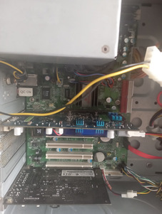

Reply 22 of 52, by shevalier
Hoping wrote on 2023-10-19, 09:37:
+100 point to stability
file.php?id=159601&mode=view
In fact, the frequency correction of the error amplifier's negative feedback depends on both capacitance and ESR.
But no one uses the perfect setting because as capacitors age, the capacitance drops. And in a year you can get instability.
In real life - from 0.5 to 2x from the original capacity with approximately equal to the original ESR.
Well, and the color matches the PCB.

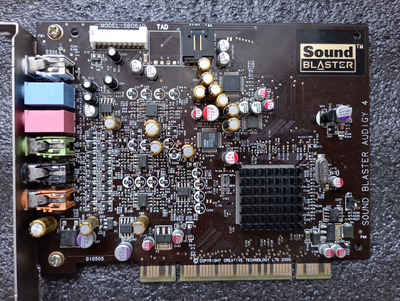

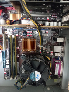

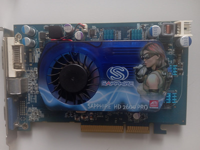

Reply 23 of 52, by shevalier
shevalier wrote on 2023-10-19, 09:53:
For example
-Why was Jetway K8T8As unstable?
Because the wrong transistor was used to power the HyperTransport.
Because the color of the capacitors did not match well with the color of the PCB.
Blue goes well with green, so the motherboard works well.
If these were green Samwha FB, then the motherboard would work perfectly.
-Why didn't the Radeon HD2600Pro AGP work at standard frequencies, but now runs great when overclocked?
Because Sapphire engineers soldering the frequency compensation circuit of the GPU power controller in the wrong pad.
Because blue on blue is just perfect
-Why does the Audigy SB0610 sound worse than the first version of the SB0400?
Because there was no need to plug extra electrolytic capacitors into the signal circuits.
Because dark brown goes perfectly with red.
And who will now argue that the color of the capacitors does not matter?
PS. The Audigy didn’t turn out to be very monochromatic, but I’m too lazy to redo it.
Because the result has been achieved.

Reply 25 of 52, by shevalier
CharlieFoxtrot wrote on 2023-10-19, 14:35:
For example
Now, this is finally some top level engineering analysis, which is typically missing from this site!
The board contains an integrated controller for power supply and voltage supply sequence of the motherboard. Therefore, powering the HyperTransport (1.2V) from the AGP+northbridge_core (1.5V) makes no sense at all. The HyperTransport power supply will appear later than the AGP power supply. Initially, there was a MOSFET with an Rds of 100 mOhm, which gives us at peak (1.5-1.2)/0.1 = 3 Amperes.
According to the specification for HyperTransport, this is enough, there is 2 Amperes (from memory)
In practice it turned out not to be the case. A MOSFET with an Rds of 30 mOhm is the solution to the problem.
Also, the idea of ​​controlling the voltage by connecting additional resistors in feedback directly to the GPIO is quite flawed.
This results in increased noise from the GPIO pin itself into the powered circuit.
Who needs this?
The motherboard is quite rare, and no one will resolder the transistors.
Therefore, at the blue PCB should have either green or blue polymer capacitors.

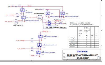

Reply 26 of 52, by shevalier
Or so?
Why, if no one will repeat it?

Reply 28 of 52, by shevalier
pentiumspeed wrote on 2023-10-19, 15:20:
Hoping wrote on 2023-10-17, 14:15:
I repeat that I am not an electronic engineer
Can you expand on what you did to solve the instabilities of the memory and the microcap is?
Cheers,
see screenshots above in the post.
Q26,27,28 are extra.
They try to duplicate Q21,22,23,25, which change the reference voltage for the memory regulator depending on the S3/S5 power state.
And they (Q26 to ground) break off negative feedback, which in itself is nonsense.
At the same time, being in a semi-active state, these extra transistors the noise from the GPIO.
Which leads to oscillations of 150-200mVolt.
PS. This motherboard was made by me for audio measurements and I absolutely did not need a 30 dB needle at a frequency of 13 kHz at spectrograms.
Now I'm playing Dungeon Keeper 2 with Diamond Monster MX300 on this motherboard 😀
Because I’m tired of audio development as a hobby.

In the beginning, everyone sculpted anything. For example, Gigabyte
1000
And it looked ugly
Then they came to their senses, and it began to look like a corporate identity
1000
Asus - similar. Sometimes it’s eye-catching, sometimes it’s downright stylish.

Reply 33 of 52, by shevalier
pentiumspeed wrote on 2023-10-19, 16:33:
Is this your motherboard in this picture (the blue one)?
I consider all boards with heavy power (those AMD and P4 CPUs) using 2 phase VRM insufficient and I had instability in past. When I moved on to boards with 3 phases or more, I had stability back. 2 phase VRM is also make more noise if you are all about quality of audio. 3 phase and at least 5 to 6 bigger diameter capacitors, not the smaller ones and lot more MLCC capacitors.
Cheers,
On the element base of those times, one phase had a power of approximately 35 watts. For a 100W CPU, two phases is not enough, but I'm not a fan of Brisbane and Windsor. This board running with mobile Turion 😀
Strictly speaking, the current through the capacitors depends on the number of phases. The more there are, the less current.
You can design 1 phase at 100 Watt, but this will not be optimal.

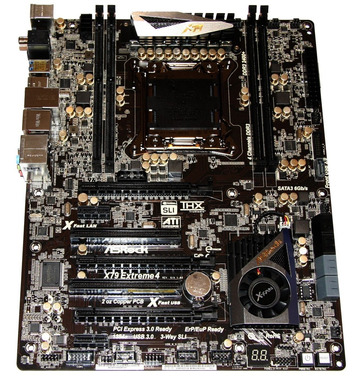

That seems like a very good explanation, and this thread does seem aimed at explaining how to change capacitors on old motherboards with a point of view from the second decade of the twenty-first century.
So is it possible that in the A7N8X-X in which I use the three 470uf 16v capacitors, these become hot because the VRM only has two phases and is too much current for then because of that? In that case, would putting some SMD polymer capacitors of, for example, 330uf 16v in parallel on the back side improve the situation?
Note, the gold capacitors that Asrock used, for example in the X79 extreme4, also give an interesting appearance on the black PCB.😉
I have one of those motherboards that I bought damaged for €6 in case it had an easy repair, but it turned out to have several deep scratches on the back that cut several tracks.
I don't know how those capacitors would look on a green PCB, I'm thinking of using them for the motherboard of a DELL GX280, which were very famous because they all failed because of the capacitors. I already changed the capacitors years ago with electrolytic ones, but hey, you have to use your free time for something.
I also use a Mobile Athlon 64 3200+ DTR (https://www.cpu-world.com/CPUs/K8/AMD-Mobile% … 3200BEX5AR.html) on my 754 build, it is very good for undervolting and very cold.
    484.92 KiB
    722 views

The picture shows the VRM of a motherboard supporting FX9370 with a 220W TDP.
Considering that the motherboard has branded polymer capacitors and the conversion frequencies are closer to 100 kHz than 50 (like old motherboards).
Here are only 3 * 270 uF for 220 official watts (And yes, I know that TDP is not equal to consumption)
http://www.nfjapan.com/datasheet/KZG.pdf
