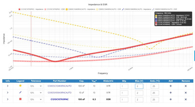

Hoping wrote on 2023-10-21, 14:59:
I have seen articles and videos that indicate that the use of MLCC capacitors in parallel to polymers or electrolytics, if the capacitance of the MLCC is calculated correctly, does not have to be very high, and the MLCCs have greatly increased the capacitance with new technologies, you can still reduce the ESR further at the typical switching frequencies and improve the ripple suppression, I misunderstood everything, or it is more or less like that.
https://ksim3.kemet.com/capacitor-simulation
It depends on the conversion frequency.
On older motherboards with powdered iron cores, it is not high (up to 100kHz). There, MLCC do not really work due to high impedance (not ESR) due to low capacitance.
Modern regulators are capable of frequencies of several megahertz, and polymer capacitors are no longer really needed.
