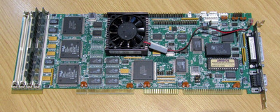

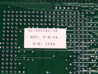

Not sure if anyone here can help me but I'd like to repair a SBC which has failed recently. Although I have quite a bit of electronic repair experience, computers are my nemesis so please be gentle.
In a nutshell, I have an old 90s era pick & place machine which is run from a Pentium SBC plus a load of other cards for graphics, stepper motor drivers etc. etc.
Recently, I turned the machine and was greeted by some bleeps and a load of rubbish on the PC monitor, it wouldn't even boot to the BIOS. I immediately suspected the BIOS battery and pulled out the SBC card.
This card is a Pentium SBC marked 92-005180-0X. There are no other manufacturers markings on it, apart from it has an American Megatrends BIOS Eprom marked "AMIBIOS, Pentium CPU PCI ISA BIOS" so I know it's an American Megatrends BIOS running everything.
On it I found the Dallas DS12887A real time clock IC with internal battery. A quick search on Ebay UK (I'm in the UK) found some old "working" pulls. I bought a couple and proceeded to fit a socket and then try the modules, but it made no difference.
Every time you try and boot this machine, you get one long beep followed by 3 short beeps and a load of rubbish on the monitor, then it hangs.
I don't particularly trust Ebay in these sort of situations so at the same time ordered the Necroware NWx287 from a guy in Portugal. Apparently, this board is a drop in replacement for the Dallas DS12887 but the seller said he was not sure if it would work as a replacement for the DS12887A (I still cannot really see the difference after looking at the datasheet, but generally "A" versions of a device should be backwards compatible). I know this module was designed by a guy who lurks on here, Mr Necroware.
Anyway, some time passed and the new NWx287 RTC board arrived. I fitted it in to my SBC and this time I got nothing, no beeps and nothing on the screen. That's odd I thought, so I fitted one of the old DS12887A chips back in to the socket and still got nothing. It seems as if the NWx287 has somehow made the issue with my motherboard worse!
Whilst all this was happening, I was searching for a replacement SBC and I found an identical one from a guy in Holland. When this board arrived it behaved exactly the same as my failed one - one long beep followed by 3 short beeps and no boot.
I looked up the beeps online and it seems to point to memory or RAM failure. I've tried new RAM sticks in both boards and no difference. Here's other troubleshooting that I've carried out:

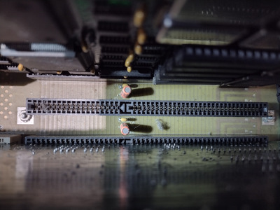

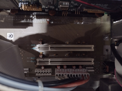

Also attached are photos of the spare connectors available on the backplane board. Hopefully a Post card can fit?

Also, my PC is a backplane style which the SBC plugs into, so not sure the best place to plugs the post card in to.
Same place other cards plug into, the backplane.
Do you have another backup backplane? If both SBC cards fail in same way it would be prudent to eliminate all common factors. That means anoter ower supply, another backplane, another ram, another video card (if its separate), etc

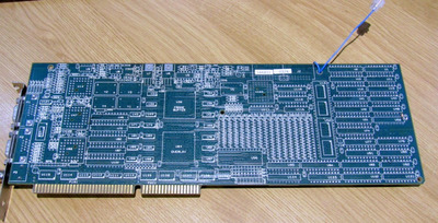

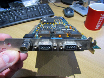

Actually, the graphics card is somewhat special in that it's a "machine vision card" used in industrial applications, as well as having VGA outputs it can capture images from two CCTV cameras.
Maybe a good step would be to get a simple old VGA card from somewhere?

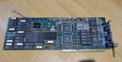

post photo of this video card please
Venture wrote on 2023-11-03, 20:29:
Definitely try another ordinary ISA graphic card, you can also try PCI VGA since Pentium SBC supports PCI bus.

Maybe, I'm not sure. Only way to tell is get another, more simple grahpics card. Attached is picture of current graphics card. For reference, it's Scorpion machine vision card (that's all I know). The top VGA connector is used for the monitor, the middle VGA connector is for two camera inputs (I think) and the bottom BNC connector is used for another camera where you can overlay video on to the PC screen, so it basically mixes the camera input which graphics output.
rasz_pl wrote on 2023-11-04, 00:46:
I will just have a look on Ebay UK but I'm not really sure what to look for. I'll check it out and maybe post some links later? Not sure if I select a random old graphics card on Ebay it might be too new & not work.
CY7C199 is SRAM so that should be cache. I dont know why there are 6 chips, weird number for cache. Replacing 12ns cache SRAM with 20ns definitely has potential to stop the board from booting completely, except if it was Cache bios should still have chance to beep error codes. The one ebay $4500 listing for that SBC has all 8 soldered in, picture quality is terrible, but it almost looks like -15 version chips.
You're right. Originally the board has 8 RAM chips on it. When I took the photo I had already desoldered two! Initially my idea was to desolder one at a time, swapping it for one on the other Pentium board just in case one faulty RAM IC was bringing the whole SBC down. I quickly got bored of that idea and went for the option of buying the slower RAM chips on Ebay and installing them, also a shitty idea. For reference, the board behaved the same with 8 RAM chips, 6 RAM chips or zero RAM chips, I tried a few different things! 😀

Venture wrote on 2023-11-04, 16:56:
resolution too low to read CHIPS chip markings, is it something like F82C451?
I have two graphics cards both the same. One is in working machine, other installed in space PC.
and both give same picture/beeps in both backplanes with two different power supplies, and with different RAM, and two separate SBCs? 😒
both have same jumper settings?
So its definitely cache 😀 Cache initialization is later in boot sequence, 2 missing chips will result in BIOS not detecting any and leaving disabled cache.

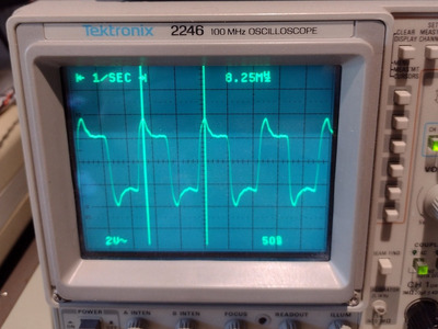

My best theory right now is ISA clock? Do you have a scope? Measure ISA pin B20 (CLK) in working 486 setup, and then again with Pentium SBC. There is a slight chance Pentium board starts with most conservative ISA divider (4-7MHz) letting video BIOS initialize, but then switching to higher clock (8MHz) resulting in garbage on screen.
Sure, I have a scope. Never probed a PC processor before so will need to check datasheet for pinout. Also, is this test to be done with processor in place or removed?
Right, thanks for the info. I've just done this and it's a bit inconclusive:
1. 486 board provides an 8MHz or so square wave. Photo attached. It does this pretty much as soon as you power up, and stays like that. The waveform looks a bit nasty, but I am not too worried about that because I am probing on an ISA connector a couple of places down from the SBC, and I'm using a bit of wire to get down in to the connector, plus I have a long ground wire attached to the case. These are probably the reason for the wobbly waveform.
2. Beeping Pentium SBC does indeed start at a much lower clock frequency, but only for a few milliseconds, then quickly reverts to 8MHz clock. Video link here. https://vimeo.com/881627944?share=copy
I am not sure if this is long enough to make the graphics card go wrong. The lower clock frequency disappears so quick that unfortunately I can't say what the lower frequency is, but guessing around 2MHz.
3. Dead Pentium SBC does the same with the clock as the beeping one.
One slightly worrying thing is that the beeping SBC now does not show any video, not even the garbage on the monitor. I think this is due to either the contacts on the board or the backplane becoming tired. It happened a couple of days ago and I re-seated the SBC and it started working again.
