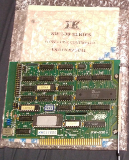

Reply 23 of 42, by BitWrangler
I got this one earlier this year, yet to test it, not in "XT mode" at the moment, don't have any machines ready. At the same time got a Seagate ST-02 SCSI/Floppy but that one is reputed only to have the SCSI BIOS and not have floppy code so motherboard dependant.
    317.06 KiB
    898 views
    High density floppy controller?
Reply 24 of 42, by Horun
Nice ! Kouwell made a few diff 530's with BIOS that I know of, yours is a later model. All support DD and HD on a XT afaik. There is not much on the D rev, if you have time to save the bios, take some pics of the manual would be a great add to Vogon's Library.

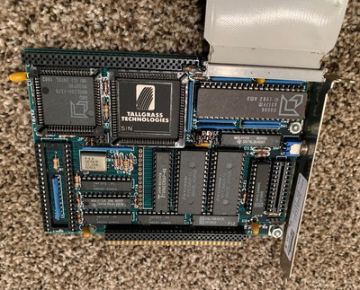

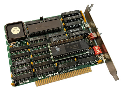

Reply 28 of 42, by Jo22
Personally, I think that approach is the wrong way round.
You're treating the symptoms, rather than the cause.
But that's just me, of course.
The problem, I think, is the 8-Bit IBM PC, not the CF card or IDE interface.
Fixing the IBM PC design first by making it fully 16-Bit is more reasonable, maybe.
Either use a bus expander chip and widening it from 8-Bit to full 16-Bit i/o (with the 20 bit address range sadly being still in place).
Or, fix the motherboard and use an 8086/V30 proccesor?
The multiplexing issue (8088 and 8086 do differ here) surely is a bit of an issue, but maybe a CPU daughtercard holding the 8086/V20 can hold some glue logic and the RAM?
Or maybe, just include an IDE interface on the 8086 daughtercard, so it has full 16-Bit i/o?
Edit: Here's a commercial solution to fix an IBM PC. Orchid Tiny Turbo 286.
216.78 KiB
817 views
Source: https://www.computinghistory.org.uk/det/70883 … Tiny-Turbo-286/
While it's still not upgrading the PCs 8-Bit design to 16-Bit, it does have a real 80286, at least.
By tapping the pins on the 286 socket, it might be possible to wire on a real IDE host adapter/network card+XUB.
Edit: There's another card. The pin bar next to the 286.. Is that carrying ISA/AT bus signals?
193.91 KiB
816 views
Source: https://forum.vcfed.org/index.php?threads/tal … elerator.80428/

Reply 33 of 42, by mkarcher
Jo22 wrote on 2023-11-05, 11:04:
The CF card is not a problem at all. A standard CF card will work perfectly with 8-bit I/O cycles only. This is an optional feature in the ATA standard, but a mandatory feature for CF cards.
The IBM PC is not a problem, it is an 8-bit architecture which works fine for what it is supposed to do. It did not really age well, but as a "professional level personal computer", one tier above the standard home computers, the architecture is fine.
The IDE interface is not a problem too. It makes a lot of sense in an AT to transfer the hard disk data using REP INSW / REP OUTSW in a 286-based system.
The problem thus is not any of the components, but the misguided attempt to combine them together. The 16-bit IDE interface is unfit for a the PC/XT 8-bit architecture.
The issue, especially with IDE, is that you must perform 16-bit transfers on the system bus, because the usual IDE hard drive can not deliver data in 8-bit chunks. On the other hand, the 8088 can not issue 16-bit transfers. When you perform an IN AX,DX instruction on an 8088 with DX=1F0, the 8088 will perform an 8-bit port read from port 1F0, followed by an 8-bit port read from port 1F1. There is no way for a bus expander to recognize whether the 8-bit access to 1F0 is the first half of a 16-bit access to 1F0, or it is a genuine 8-bit cycle. I generic bus extender is thus impossible. A specific bus expander for IDE is possible, and that's exactly what the XT-IDE hardware is foing.
When you do that, it's not an IBM PC/XT anymore. You can build compatible systems using the 8086, like the PS/2 model 30 or the original Compaq Deskpro, but as they predate the IBM AT, they do not have a 16-bit expansion bus.
There are multiple processor replacement solutions, for example the Intel Inboard 386, which is likely the most sophisticated one. When you build a retro system with a 286 or 386 processor, though, why would you pick an XT (or compatible) as base today? Starting with a 286 AT-type mainboard makes more sense than plugging an AT-on-a-card into an XT mainbaord...
I guess that's for a piggyback 16-bit memory expansion card.

To my knowledge, there are neither CPU accelerator cards for 8086 PCs, nor 8086-based CPU accelerator cards for 8088 PCs.
Rather, there are a dozen of 80286 and 80386 CPU accelerator cards for 8088 PCs.
