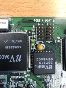

Hello everyone, I was wondering if anyone has a schematic diagram for the Diamond Edge 3D 3240 PCI graphics/sound card? Or if anyone has experience with repairing these cards. I have a 3240XL and one of the surface mount capacitors has blown (C97) - these have no markings on them whatsoever and the blown one has completely vapourized.

Reply 1 of 12, by rasz_pl
It looks mechanically cracked off. Measure what both pads connect to, if its 3.3/5 supply and ground then any 100nF will do.
Does the card not work without it? Missing cap rarely results in dead board, and since it looks mechanical I would take a closer look at all the solder joints on big chips.

Reply 3 of 12, by Horun
Hmmm if it did blow would be a bit odd being a SMT type but if did might have taken out something with it OR the opposite: something died and blew that cap. Would expect the Tants to short or blow first if a supply/age issue.
I would check those Tants for a short before moving forward. Sorry have nothing else to add.
Reply 4 of 12, by Zed80
Slight update - tried replacing the missing/blown capacitor with a 100nF and still nothing. When plugged into PCI it has power all over the board but nothing coming out. The yellow tantalum is testing OK.
It is very odd - next step is taking the bios chip out and reading it and hopefully finding the BIOS image online to try in a new chip.
The board is behaving like it has no power (chips don't warm up, nothing comes from the outputs) but you can read the voltages etc all over it.

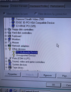

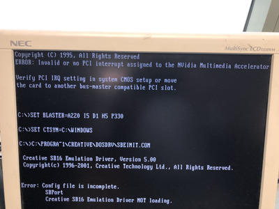

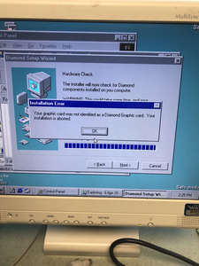

OK some good and some bad with the card today. U18 l5 was 5V and leg 4 3.6v from memory.
I put the card into a Pentium 233MMx running win98 alongside another video card - Windows detected the Edge 3D (well, it detected the presence of a PCI video card) and I was eventually able to load a driver, however the Diamond Edge self extracting exe driver program claimed there wasnt a diamond edge card on board (perhaps detecting the other card first). With the driver loaded Win98 then would hang whilst booting (unless in safe mode).
When I tried loading a bare NV1 driver it really didnt like it and dumped the boot during PCI config.
pictures attached.

Reply 11 of 12, by Zed80
There was only two - for some reason it loaded the S3 card driver when it loaded the Edge 3D driver as well. I ended up deleting that S3 card/driver but it made no difference.
I am wondering if Win98 is picking up the bios from the Edge 3D but there is something wrong with the NV1 hence no video output. I’ve found a pin out for the SGS Thompson version of the NV1 which labels the pins so when I get a chance I’ll try to see if I can pick up any signs of life with a multimeter.

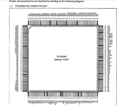

Reply 12 of 12, by Zed80
Well with an ancient VGA card in as ISA slot it booted windows in safe mode but still would hang during normal Win98 startup.
I found some information on the SGS Thompson version of the the NV1 (The STG2000) which has pinouts of the chip as below

I tested with a multimeter the VDD leg and it was 3.3V, GND pins were 5V. I don't have an oscilloscope so I am quite limited in what is testable.
The full spec for the STG2000 is here;
