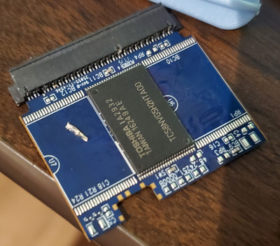

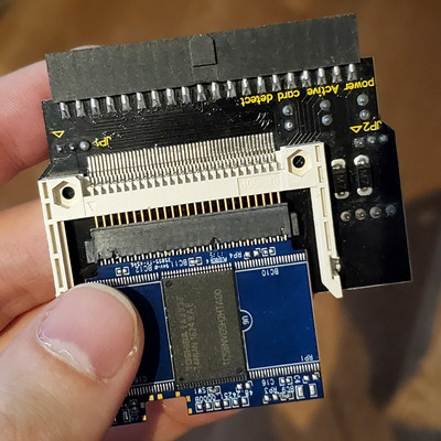

One of my CompactFlash cards that I use for passing drivers between systems seemed to require an unusual amount of insertion force. I didn't think much of it and pressed it in, where I then heard a crunching sound. This was not good.
I noticed that the male pin on my adapter had bent slightly. It had caught the edge of the female connector inside the card, pressing against it until it broke. Surprisingly, I somehow broke two connectors. Maybe one of them had been broken previously and the card continued to work? I only noticed the one bent pin on my adapter, so this was unexpected.

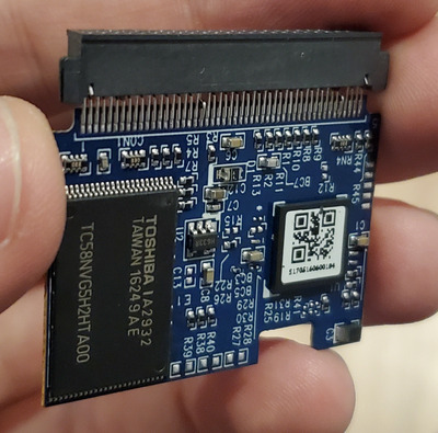

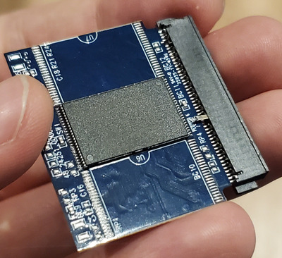

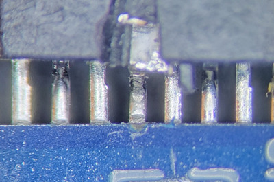

I had a lot of work stored on this card, so I cracked it open to assess the damage. I found the two connectors that had sheered off and, luckily, the traces were still intact.
With care, I soldered the connectors back on with the help of a solder bridge. I was then able to retrieve all of my data. I've included some photos here for those who might be interested.
This is the first time I've ever damaged a CompactFlash card before. Has anyone else experienced a similar accident on insertion?

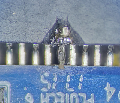

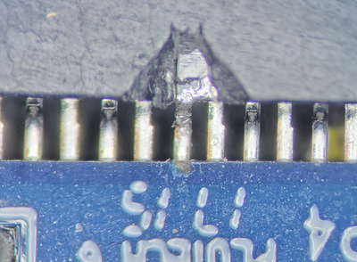

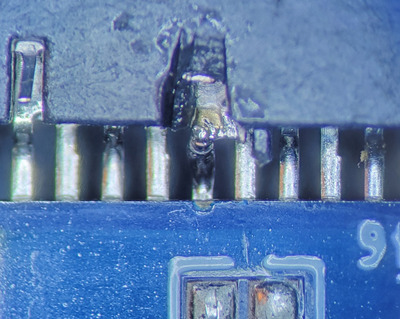

Here are some more photos of the joints before and after soldering. The photos do not do this repair justice, as there wasn't a good angle to show the bridge without so many reflections spoiling it.
Soldering the connectors back on was actually quite easy. The hardest part was getting the cracked edges to line up close enough to build a solder bridge.
I also pre-inserted the card into the adapter, to avoid any further mechanical force on the joint before I had finished the data recovery.

Never experienced it with CF cards specifically, but can se how it could happen if the corresponding pins in the male connector were a little bit bent.
Quite a few of those pins are ground connections. The card should work as long as one of them is connected, which could explain earlier broken connections that didn't affect the function.
