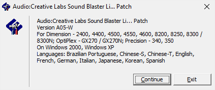

I found that Creative is mirroring the same driver pack as provided by Dell (or vice versa). Dell's installer though reports this driver pack as a "patch", which explains why it wouldn't install without having the device having already been setup with drivers previously.

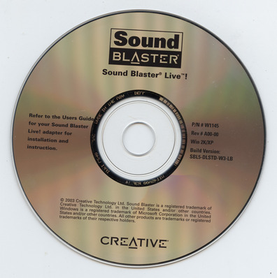

Reply 6 of 10, by Kahenraz
I found a copy of the Dell driver CD, which includes the bundled applications, but it still has the same problem where it won't detect the card without having drivers for the card already installed. This is a really bizarre chicken and egg problem.
https://archive.org/details/Sound_Blaster_Liv … Technology_2003

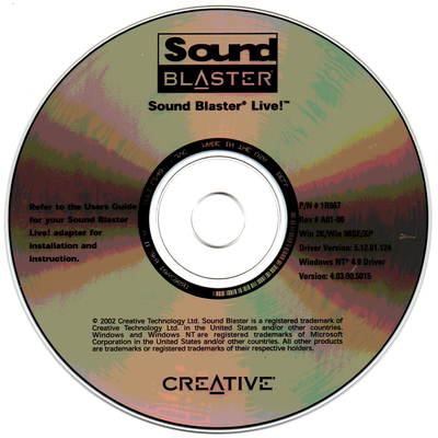

Reply 7 of 10, by Kahenraz
I found another one. Same problem; it won't install if drivers aren't installed first.
https://archive.org/details/sound_blaster_live
(Version 5.12.01.0124)
