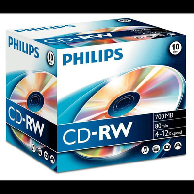

Reply 12 of 26, by Lutsoad
Thank you all guys, I guess I'll just buy a CD-RW disc from an available manufacturer and see how the older drives deal with it.
Found these, could they work in an older 4X CD-Rewriter or is it still dependent on the surface of the disc or the firmware/laser of the drive used?

Reply 14 of 26, by mkarcher
Lutsoad wrote on 2023-11-10, 07:38:
4x - 12x media are "high speed CD-RW media", which were not yet around when 4x CD-Rewriters were produced and are not handled / recognized by firmware that was written at that time. If you can't get a later firmware upgrade that added "support for high-speed CD-RW media at 4x", it will most likely not work in a 4x CD-Rewriter. You can still buy media like these MAXELL 1x-4x media, which is a random "Google Shopping" hit when searching with a German IP. This is no endorsement for this specific seller or product. Media like these should work in all 4x CD-Rewriters.
Reply 15 of 26, by darry
mkarcher wrote on 2023-11-10, 16:05:
EDIT : @mkarcher , I realize that I pretty much reformulated what you said. I just wanted to be more explicit in order to reduce the chance of someone misunderstanding.
Yes, an older 1x-4x capable CDRW drive will not necessarily be able to write to newer 4x-12x media .
While the 4x speed overlap between writer capabilities and media rating suggests that it should just work, this is generally not the case. 1x-4x CDRW media and 4x-12x CDRW media need different write strategies, even when each is written to at 4x .
Consequently, unless the older 1x-4x CDRW drive has an updated firmware that implements the write strategy required for 4x-12x CDRW media, it will not work reliably or at all with 4x-12x CDRW media . If the writer has updated firmware that implements the write strategy required, it will be able to write to the newer media, but only at 4x.
That was the way I understood things to work when I still used such an older drive. Things might have changed or I could be misremembering.
Also, one should be careful about misidentified products for sale online. Always trust the part number or manufacturer packaging above what a seller might think they know about what they are selling
Reply 16 of 26, by darry
These are unlikely to work, even at 4x on your older drive unless there is a firmware update to allow it.
Please see @mkarcher 's comment (and mine).
EDIT : Sorry for the instance, the objective is to try to make sure that these are not purchased unnecessarily.
