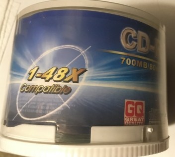

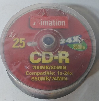

Reply 5 of 23, by Horun
Agree ! older Toshiba, NEC and Plextors are good at reading CDR, though with proper CDR media is less of an issue with Generic slow cdrom drives even when burned at 2x or 3x the older cdroms max rating.
I typically use something like the pictures (where they state 1x-16x or 1x-24x compatible) both Imation and some older HP branded (they were 4x-32x compat iirc) CDR are really good and state the compat range....
added: I have some generic GQ labeled 1x-48x that work OK reading with most slower cdroms but not 100% like the Imations so far..(am mostly burning with a LG Bluray/DVD/CD burner).
added2: those type can also be written to with my 8x burners w/o issue as well...seems it works both ways from my experience:)
