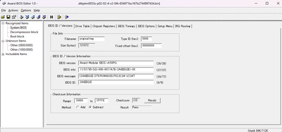

Since I could not find anyone who already edited awdbedit to work with modern compilers/sdk's (and released it somewhere) decided to do it as mental arithmatic.
https://github.com/consp/awdbedit/releases/tag/1.0.3
As usual with these things: YMMV
Should keep working with modern versions of windows and compile with modern MS tools available. I also updated the PCI IRQ Routing table tab to allow a bit more flexibility since it's something I might need in the future and was the reason for fixing it (since I need to edit a value of 2 number to three numbers).
Since I now have a working build setup, maybe I'll do updates if not too hard and my mental state allows it. No guarantees but the code is not too complex. If you want file a bug report (with sufficient detail please).

What BIOS revisions does it work with?
Reply 2 of 5, by consp
debs3759 wrote on 2023-11-14, 19:17:
Originally 4.51PG, 6.0 and 6.0PG.
I've added 4.50PG. Reading works (which was what I needed for the INTA-D values), altering I have not tested yet.

Updated the file since I found a bug which might be the cause of some "corrupted" bioses. Technically all data was there but also some old data.
A simplistic decompression algorithm (like the one in the app) might hang on the bonusdata.
