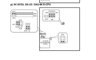

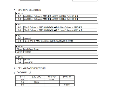

I have an i486 SX 33MHz SX797 CPU with no write-back, its 5 volts and I'm trying to test a GA-5486AL ver 2A motherboard with this CPU, the motherboard supports S-Series CPU's that my CPU is (SL enhanced) but in the manual it doesn't mention the SX in the CPU supported list it only says S-Series are supported and the DX2 so I'm wondering if I can use this SX in this motherboard
In the manual there isn't a setting for it and the closest to it is for the 5V Intel DX-33/DX2-66 S-CPU would using this one be ok for my 486 SX 33?
