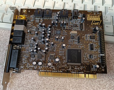

Reply 23 of 38, by justin1985
Bruno128 wrote on 2023-12-17, 11:02:
As mentioned above, yours may be Dell OEM (even if the model number matches) then those are picky. If you would maybe post pics of labels on your cards here for identification?

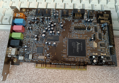

Here are the actual cards:
1.78 MiB
966 views
SB0090
1.75 MiB
966 views
SB4760
More suggestions: update the BIOS, try installing Audigy prior to VIA drivers, just on bare bones Win98. Try XP to eliminate hardware incompatibility.
Installing on barebones Win98 without any other drivers worked!
So did installing on a CF-IDE adapter with SATA disabled in the BIOS, but the VIA Hyperion 5.09A drivers installed for other components. So that seems pretty conclusive the conflict is between the Creative cards and the VIA SATA/RAID driver!
Without the Creative cards though, the Hyperion 5.09A drivers make the system much faster and more stable than the previous ones (I think I was originally using 4in1 4.56 from Phil's website plus 6.10c separate RAID driver from VIA). Would it be worth trying any particular further version of Hyperion to see if the conflict goes away?
It wouldn't be the end of the world to just use an IDE drive instead, although it would be a shame in terms of cable management in the compact case I'm using (and considering this board did happen to be the one with the Plus southbridge that does at least work with SATA SSDs).
How likely is it this incompatibility might go away with the Audigy 2? (it sounds like the VIA - Audigy problems others have described were more about bus and memory type stuff?). This certainly feels like it reminds me why I felt VIA were worth avoiding back in the day ...)

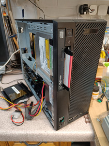

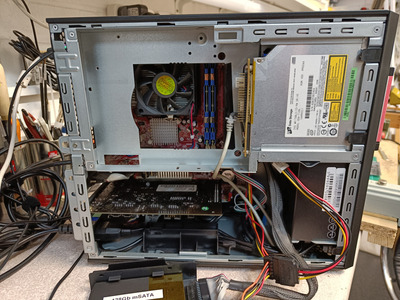

It wasn't without some frustration though - it turned out that the mSATA to 44-pin IDE adapters that I usually use (with black screw down 2.5" drive casing) just wouldn't play ball with this motherboard. Several mSATA drives in several different adapters of this type were all detected, and accessible, but kept getting corrupt data errors. The same mSATA drive in one of the smaller un-cased 44pin adapters worked absolutely fine. Weirdly, both types of adapters use the same chip. More general VIA flakiness?
1.97 MiB
757 views
Sk754 in L12 case
I've got the system mainly built up in the tiny FSP L12 mATX case that I had in mind. But having to use IDE rather than SATA seems to make it a bit too much of a challenge to get everything packed in! Trying to force the SSD drive in amongst the mains power and USB3 cables was just too much, and I didn't even try connecting the slim DVD yet.
1.14 MiB
757 views
Sk754 with slim drives
I had used this case for an AM3 Athlon II from my partner's old PC, which I had built up for XP gaming, but hadn't ended up using much at all.
I recently picked up this Silverstone "SFF" mATX case, which might make a better fit for this build if I'm using IDE. It is short and shallow, but quite wide (with a full size ATX PSU alongside the CPU, like many early OEM mATX cases). Not ideal for the space I have available, but I think it is a nice case ...

Reply 30 of 38, by Bruno128
I like both cases. Silverstone can loose the card reader and then there were silver bezel FDDs produced.
But how did you fit the floppy drive in that FSP L12?
It's a regular slim floppy drive harvested from a cheap USB floppy, with a 5 pin header connector crimped on to the wires in place of the USB-A plug! It works great and the BIOS on most motherboards, including this one, treats it as a native floppy, and it gets mapped to A:. I 3D printed a face plate for it from Thingiverse, but it doesn't quite fit perfectly - might have to try again!
The L12 case has a slim 3.5" bay, but clearly intended for some kind of shallow card reader type thing. There was a back stop bent up from the steel of the drive tray assembly which I chopped out with the cutting disk in a Dremel (then filed smooth etc)

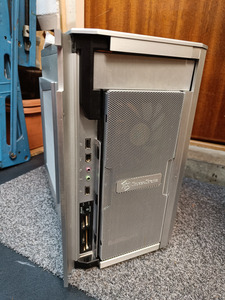

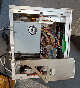

The Silverstone case is great in a lot of ways, but I can kind of understand why the design hasn't been perpetuated ...
1.62 MiB
655 views
Silverstone Sugo SG03
The full size ATX PSU sits over the CPU, and everything has to be disassembled to get to anything out. To get the PSU free, you have to remove the 3.5" external drive assembly first. And you need to remove the PSU to get to virtually anything apart from the expansion cards (only the floppy cage assembly to remove for that ...)
I kind of wonder about trying to get another small SFX PSU and mounting it in a converter bracket, to make it feel a bit less constrained in there ... The current PSU is a generic AcBel OEM 330w that originated with the AM3 system. It only has a small fan on the back and intake vents only at the other end, so blank faces are facing both outwards and over the CPU.

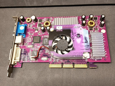

I managed to pick up a GeForce 4Ti (only a 64mb one, as the same seller had both 64mb and 128mb listed as auctions, and I managed to bid on the wrong one). Still, it pretty much doubles the 3DMark2001 score compared to the Radeon 9250! Getting the drivers working nicely seems much harder than with the Radeon though - too old and Windows won't boot with a Windows Protection Error. Too new and 3DMark won't complete all stages and the 3D gets glitchy ...
222.82 KiB
655 views
GeForce 4Ti
The stock cooler it was supplied with is PAINFULLY noisy though! The thermal paste was totally dried out, which I replaced, but there was also a kind of rattling/ scratching noise that was pretty disturbing. I removed the graphic cover part which improved it a little ... I've ordered a generic "flower" type VGA cooler from AliExpress now ... I guess these early actively cooled graphics cards were just badly designed?

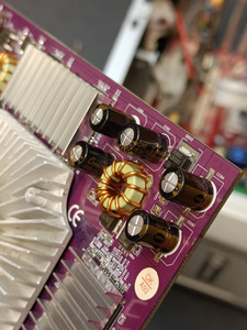

Reply 34 of 38, by Repo Man11
Because of the resolution, I could be mistaken, but some of the capacitors on that card look like they may be failing?
Reply 35 of 38, by justin1985
Repo Man11 wrote on 2023-12-23, 21:17:
Thanks for noticing this! I hadn't noticed at all, but you're right.
All but one of this cluster of 5 x 1000uf 6.3v "Canicon" capacitors are bulging, and one even has some gunk starting to form on the top.
745.37 KiB
552 views
Bulging caps
Perhaps this might even explain the occasional flickering on and off of the screen that seems to go away once the system is "warmed up"? (I was blaming the later driver versions).
There's 8 of these identical capacitors on the board in total so I'll order enough to replace them all ...
It's kind of interesting that the PCB has pads that seem to fit the SMD version of the capacitors. I don't know if they tend to be better quality? (They don't tend to have the vent lines do they?). I'm more confident soldering through - hole though!
