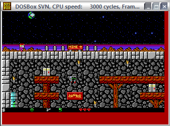

Reply 87 of 101, by VileR
Works really nicely! A few things tested so far:
- VGA 320x200 works as expected (with your caveat in mind)
- CGA mode: games like Bricks (freeware) and Trixter's CGA Compatibility Tester all seem to give proper results when adjusting the screen position left/right/up/down
- Lost Tomb's "screen shake" works beautifully in CGA (RGB/composite) and PCjr modes
Bugs and/or funny stuff found:
- I know you didn't mention EGA testing, but with machine=ega the borders don't look like they should; text mode and hi-res mode have no borders, and in 320x200... well:
14.52 KiB
2413 views
- Moon Patrol (like other Atarisoft CGA games) lets you roll the screen left and right with F9 and F10, respectively. If you roll it to the right too much, the window will eventually stretch to amusing proportions:
9.92 KiB
No downloads
EDIT: I guess the patch is trying to accomodate the entire image no matter what, thus causing the visible area to grow.
Question is, would real CGA hardware allow you to roll the screen *that* far to the right? Obviously the image would just get cut off as it moves beyond the visible area; but some wrapping or capping might happen before it gets to the point shown in the screenshot, because that's quite a bit wider than the total duration of a single scanline (=456 low-res pixels).
