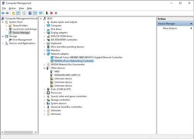

Here is one of my 'not so old' PCs:
Windows 10 x32 works surprisingly well, but Win10 x64 was unable to install for some odd reason.
The machine has Athlon x2 4600+ CPU, GA-K8NS Ultra-939, Nvidia 6800 AGP x8 video, 512 GB SSD (SATA), 4 GB DDR RAM and some additional hardware (Labtec webcam, which works with Vista driver, some audio & midi devices).
I installed some Vista drivers, but because Nvidia never released NForce 3 drivers for Vista, Win7, Win8 or Win10 officially, I ran into some issues.
Most notably, after one graphics demo (3D Mark 03 for example), I am getting a blue screen. Also, USBs don't work (but they work with XP x32 on another HDD).
Does anyone have some beta drivers for NForce 3 chipsets?
    40.66 KiB
    908 views
    Device Manager

You can take a look here https://winraid.level1techs.com/t/nvidia-opti … r-win7-10/21787, never tried anything newer than Win7-64, but the drivers from that page always worked well for me.
Reply 10 of 11, by Bruno128
1. AGP support is removed from Win10 Anniversary update (1607) and newer. It will display, but not accelerate 3D. If you absolutely must, try installing one of the earliest builds or Win8.1.
2. You are trying to run incompatible OS/chipset combination. There are no "some Vista drivers" for nF3, not even beta ones, only force-installing XP drivers is an option. Hence USB issues, PHY issues, etc etc
Did you check the drivers that were posted some days ago?
