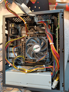

A while back I asked for advice on the platform with the fastest integrated GPU that has drivers for Windows XP. My aim was to use one of the super compact A09 ITX cases with internal flexATX PSU (rather than needing a power brick) and be able to play games right through to late XP era titles like Medieval Total War 2.
1.16 MiB
575 views

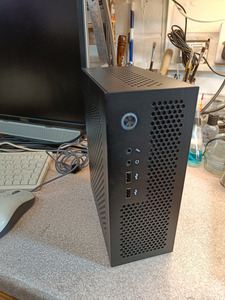

A09 case
Originally I tried an i5-3470 with an MSI H61 ITX board, but found that I was often only getting 15fps in MTW2. It seems a consensus that the final XP compatible AMD APUs had much better graphics performance, and the "Trinity" core was the final generation with official driver support.
So this time I've got:
MSI A88Xi AC ITX motherboard with miniPCIe Intel WiFi (had to swap this for an older model with XP drivers)
AMD A8 5500 APU with Radeon HD 7560D
4Gb DDR3-1600 RAM (should probably find a second stick?)
Kingston 480Gb SATA SSD (had spare)
A09 ITX case with hard drive bracket in place
FSP 280W flexATX PSU

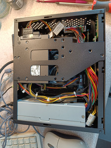

1.32 MiB
575 views
Hard drive bracket needed a "left angle" SATA cable - pretty hard to find!
1.31 MiB
575 views
All seems to be working well, and I'm really pleased with performance. MTW2 ranges between 35 and 65fps on "best" graphical detail settings, and usually around 120fps, occasionally as low as 85 or 90, on medium. 3DMark2001 came out at 24725.
I guess doubling up to 8Gb RAM would improve things further (considering the graphics take more than 1.5Gb).
I think I've seen suggestions that some later AMD APUs for FM2 will work on XP in practice as well, even if Trinity are the final ones with official support. Would any be a worthwhile upgrade? All FM2 CPUs seem pretty cheap!

I've noticed I'm getting pretty high temperatures though - around 60C at idle / web browsing in Win10. That seems a bit too high?
The cooler is only one of the smaller AMD stock ones - even the slightly taller AMD stock type with copper core is too tall to fit in this case! I wonder if removing the SSD bracket and just jamming the SSD between the top of the case and the bundle of wires around there might improve airflow to the CPU enough to make a difference?
Any recommendations for other low profile FM2/AM3 type coolers? I did try an AliExpress generic Aluminium 'flower' type, but it was wide enough it blocked one of the DIMM sockets (and didn't seem any cooler).
Reply 3 of 7, by Bruno128
Good airflow clearance does wonders. And that huge HDD bracket blocking entire path is not a good design choice indeed. Not even the most expensive cooler can do its job without air intake.

Reply 4 of 7, by justin1985
Bruno128 wrote on 2024-01-21, 18:05:
Neat. Since you use integrated graphics, switching to dual-channel RAM would give a performance boost. In that regard 2x2GB is much better than 1x4GB. Going beyond 4GB will also work, but makes little sense for 32-bit XP.
So I just swapped the single 4Gb stick of DDR3-1600 for a pair of 2Gb DDR3-1333 sticks, and got a pretty dramatic performance increase! 3DMark2001 went from 24348 to 30827! And in my favourite game Medieval2, FPS now doesn't drop below ~130fps at maximum settings. Thanks again for the tip!
Bruno128 wrote on 2024-01-24, 22:50:
RAM: timings and frequency is also important in that scenario (think of it as you would about video card memory clocks)
I also took out the bracket and installed the taller AMD stock fan with the copper core. With the slightly taller heatsink in place, the SSD now nicely lodges itself and rests between the side of the fan and the top of the case, resting on top of the rats nest of front panel wires etc, and held down by the top case. Not elegant, but it works. And temperatures, even under load, are now down to ~35-40C 😀
