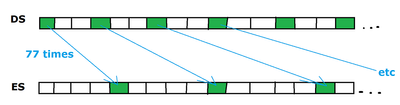

My knowledge of assembly is weak-to-medium.
This started as simple image downscale attempt, but I will ask in general.
I am trying to copy data from one location to another, but neither source nor destination are consecutive. Like this:
13.51 KiB
771 views
My code is this:
mov cx,4D ;77 is 4D in hex
mov ax, destination_segment
mov es,ax
mov di,destination_offset
mov ax, source_segment
mov ds,ax
mov bx,source_offset
dostuff:
mov al,[bx]
mov [ es:di],al
add bx,3
add di,5
loop dostuff
Is this the fastest method to do the copying (not considering loop unrolling)?
What faster way exist? What other improvements can be done?
If the destination is consecutive, I can do (inc di) instead of (add di,5), any other improvement available in this case?
Thanks in advance.
Reply 1 of 12, by Disruptor
Why don't use movsb?
mov es,ax
mov ds,ax
mov si,source_offset
dostuff:
movsb
add si,2
add di,4
loop dostuff

Reply 7 of 12, by Disruptor
When he tries to copy non-consecutive source to consecutive destination, he does not need an increment on di at all, because movsb does.
I don't know what improvement you'll get with word writes. It most likely will have unwanted side effects.
Optimizing code is different to each CPU type. Basically on an 8088 itself you prefer smaller code because filling the prefetch queue costs so many clocks. In modern CPUs write combining will help.
Reply 8 of 12, by mkarcher
Disruptor wrote on 2024-01-24, 10:50:
Why don't use movsb? […]
mov es,ax
mov ds,ax
dostuff:
movsb
add si,2
add di,4
loop dostuff
This looks like the best solution so far that meets the constraint to only write single bytes into the output range. You can still improve slightly. As already pointed out in this thread, th main bottleneck of the 8088 is fetching instructions. The ADD instruction in this suggestion take 3 bytes each (One byte opcode, one MOD/RM byte, one byte for the sign-extended immediate). You can get down to two bytes per ADD instruction by loading 2 and 4 into registers before entering the loop. This will make the loop 2 bytes shorter, which should improve performance:
mov es,ax
mov ds,ax
mov ax,2
mov bx,4
dostuff:
movsb
add si,ax
add di,bx
loop dostuff
This code is obviously longer than the code proposed by Disruptor (2 bytes less in the loop body, 6 bytes extra in the loop setup), so it's only worth it if the loop is executed like 5 or more times. 77 times should definitely suffice to make this suggestion worth it if performance is more important than total code size.
