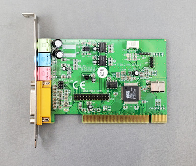

The ESS Solo-1 has a reputation for being a highly compatible PCI sound card for use with DOS games. As it can be useful for systems without ISA slots, I did some testing to see how compatible it is and what sort of issues might arise with different games.
Links to specific systems tested:
486 DX-33 / Beyond 486IP-B-2-A
Pentium 100 / DFI P5BTX/L
Pentium 4 (Northwood) 2.0 GHz / ASUS P4S533-E
The specific card I'm using is a Terratec Promedia branded card. It didn't include a wavetable header when I received it; I soldered one in after the fact.

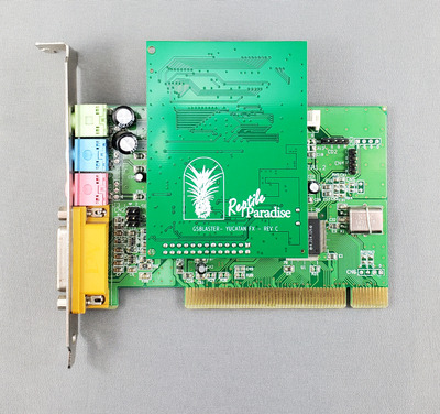

General MIDI support was tested using a Yucatan FX daughtercard, but any GM compatible card should work. MT-32 support was tested using an MT-32 Rev 0 (old) model.
1.56 MiB
1164 views
GPL-2.0-or-later
This card works with ESSVOL. The internal wavetable header volume can be adjusted via the Aux B volume option. This is useful if using this card for digital sound effects alongside an external MIDI module.

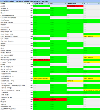

The 486 DX-33 system was used as a baseline for testing to rule out most speed sensitivity issues with games.
In this setup trying to use the ESSVOL.SYS device driver didn't work. It would just freeze on boot. The card still worked without it and defaulted to TDMA mode.
For the most part compatibility was good with relatively few issues noted.
The Secret of Monkey Island was the only game that required throttling due to speed sensitivity. In comparison using an MPU-401AT card did not need throttling to playback correctly.
Abuse failed to initialize the MPU-401 driver. Speed throttling or using SoftMPU didn't help.
Prehistorik would either fail Sound Blaster detection or freeze in game. This depended on the version of CT-VOICE.DRV used.
Some games like Quake and Shadow Warrior exhibited stuttering during audio playback. This was due to low frame rates and not a fault of the audio card. These games were not intended to run on an underpowered system.
124.99 KiB
655 views
Notes for the above chart:
Note 1 - Prince of Persia requires MT-32 with firmware version 1.07.
Note 2 - Space Quest 4 sets internal wavetable volume to zero. Use MIDITO to lock mixer before playing.

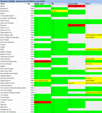

I tested this Pentium 100 setup to act as a "control" of sorts with respect to speed sensitivity. While there are still some titles that exhibit speed sensitivity (mainly re: MT-32 support), this should rule out any speed sensitive issues from the mid-90s and onward.
In this setup trying to use the ESSVOL.SYS device driver didn't work. It would just freeze on boot. The card still worked without it, but seemed limited to DDMA mode.
For speed sensitive MT-32 games, I found using SoftMPU would result in correct playback but speed throttling with SETMUL (cache disabling) or CPUSPD didn't help. This could in part be due to the limited throttling options available for a Pentium 100.
Descent also failed to detect MPU-401 hardware. This is puzzling since it does work with the Pentium 4 system I tested. I'm wondering if this might be a symptom of DDMA mode.
131.07 KiB
658 views
Note 1 - Blackthorne FM playback does not work during the intro cutscene unless throttled (e.g. disable L1 cache). Intro music and in-game music work.
Note 2 - Prince of Persia requires MT-32 with firmware version 1.07.
Note 3 - SimCity 2000's speed sensitity results in music not playing at the intro/menu. In-game music can be triggered on by switch music off then on. Use SoftMPU to fix speed sensitivity.
Note 4 - Space Quest 4 sets internal wavetable volume to zero. Use MIDITO to lock mixer before playing. Speed sensitivity issues result in incorrect instruments being played. Use SoftMPU to fix.

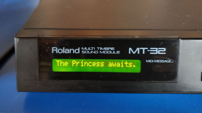

Reply 19 of 27, by Shponglefan
In my testing to date, Prince of Persia's MT-32 playback has been incorrect. No amount of throttling or other tweaks have made a difference.
Tonight I was testing a series of games with the MT-32 and when I got to Prince of Persia, it started playing back correctly. My excitement was short-lived, because after power-cycling the MT-32, it stopped working again.
I decided to test an MPU-401AT card instead of the Solo and ran into the same issue: incorrect playback. This was puzzling it works on my desktop 486 setup which also uses an MPU-401AT, but has a different MT-32. So I checked the firmware on each MT-32.
The MT-32 that doesn't work is 1.05, while my other MT-32 is 1.07. I tested the MT-32 with firmware 1.07 and Prince of Persia's music played back correctly.
That still didn't explain why the the 1.05 MT-32 had worked that one time. Since I had been testing a variety of games, I figured maybe launching MT-32 support in a different game first then followed by Prince of Persia had something to do with it.
After further trial and error, I discovered that if I launch The Secret of Monkey Island first and let it play for a few seconds (just past the logo) before running Prince of Persia, the latter game will playback correctly. I have no idea why, but The Secret of Monkey Island must be sending it some sort of instructions that allows the 1.05 MT-32 to play back correctly.
375.49 KiB
709 views
In summary Prince of Persia's MT-32 music and sound works in two scenarios:
  • using an MT-32 with 1.07 firmware; and,
  • using an MT-32 with 1.05 firmware provided I first launch The Secret of Monkey Island, let it run just past the logo screen, quit, and then launch Prince of Persia.
I'll have to re-test Prince of Persia with those other setups (Pentium 100 and P4).
