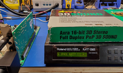

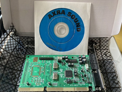

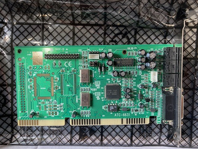

I bought this Axra "Yamaha 3d sound" card which uses the Yamaha YMF719E-S chip. The card is in immaculate condition and came with the box and everything (see pictures attached). The driver CD comes packed with a Premiere "something about you" music video and the card apparently has an 'I-phone' connector 10 years before the iPhone even came out, talk about future proofing... anyway I digress.

I am having major issues with the MPU-401. It appears I'm not getting any signal from the card to my external devices hooked up via the gameport. I've tested this using the duke3d set up utility. I get the message saying "you should here the duke nukem theme song" suggesting it's found the right port address and located the MPU-401, but none of the LEDs light up on my Sound Canvas, and there's no sound. In Windows I've set the MIDI instrument to 'external device' and I get nothing when I play Canyon.mid.
To be double sure sure it wasn't a fault with my cable/external devices I reinstalled my ESS audio drive and, lo and behold, everything operated as normal.
I tested out a joystick to see if it's a problem with gameport itself, and the joystick worked fine.
I've now installed both the ESS Audiodrive and the Yamaha card, with the audiodrive handling the MPU-401 and the Yamaha doing everything else, but it seems like a waste of an ISA slot to have two very similar cards in there. The main reason I got the Yamaha was to eventually pair it with an SB16 or AWE64, but I'm probably going to go back to my trusty Audiodrive for the time being.
The only thing I can think of at this point is that it's somehow sending everything to the wavetable header but not the gameport? I'm not sure that's actually a thing. Unfortunately I don't have a wavetable to test out (and I'm not going to buy one for the sake of this card).
I suspect this is just a faulty card, but before I admit defeat and try my luck buying a replacement, has anyone else come across a similar issue with on one of these cards? Is there anything else I could try to get this thing working? Thanks in advance.

I happen to have the exact same card (almost the same box even).
I just tested it with an MT-32 and can confirm that MPU-401 output on the joystick port does work.

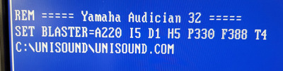

One difference is I am using UNISOUND in DOS rather than the Yamaha drivers. I've included a snapshot of my AUTOEXEC.BAT settings below.

There's a 470 ohm resistor in-line with the MIDI TX signal from the chip, it may be broken. The signal comes from pin 50 of the YMF71x chip, nicely in the opposite corner from teh pin1 dot so easy to access and measure against, assuming you have a multimeter etc.
In worst case that signal is actually damaged from past and in that case only chip replacement will help...

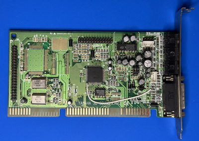

So, I had a problem like yours with a similar Yamaha card. It turns out that I had a small amount of water damage that ruined a via on the board so that the midi signal wasn't reaching from the main chip on the card to the resistor that Tiido mentioned. I added a bodge wire from the midi tx pin on the chip directly to the resistor and now it works again. I have no idea if you'll find the same problem on your card, but it's at least something else to check. Here's a pic of my very ugly bodge fix. 😀

As you can see, the midi tx pin on the main chip is thankfully right on the edge at pin 50, so it's easy to find and work with. When you get a multimeter, make sure to also check for continuity between pin 50 and that resistor.
Something else to consider as well... in my experience it seems like the most common chip pins that will come loose from a board are the ones on the edges, so even before you get your hands on a multimeter you might just want to see if that pin is loose. Be very gentle and just give it a light poke with something small and see if it moves.
