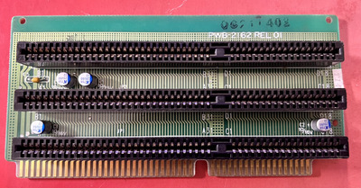

Here's some closure - I've received and installed the 386, and it has 0 problem with the existing ISA riser so that's good news! I can notice a little noise on the VGA signal that I assume is because of the lack of proper grounding and/or capacitors. I may try to improve it down the road (or keep an eye out for a better riser) but for the time being, it works! Thanks for all the input and great info.
Reply 23 of 42, by kingcake
No ground is extremely common on risers (you don't want big ground loops on digital stuff) and is not a problem. It's grounded through the motherboard. It's the caps for the VGA noise.
I restore tons of Packard Bells and they all have ISA/PISA risers. I replace all the 10uF cheapo electrolytics on the risers with 22uF low ESR polymer caps and the VGA signal goes from noisy to clean.
Reply 24 of 42, by Boohyaka
ok, thanks for the good tip. Mine as 0 capacitors right now 😁 but it has what looks like some cap potential locations.
Do you think it could help trying to install some caps on these spots? I will need to take it out to probe for continuity, but maybe you already know what I should look for? Thanks!

Reply 27 of 42, by Boohyaka
thanks again. How I can make sure those spots are actually well connected and suitable spots for caps? What should I be looking for?
Btw looks like there may be another set of 2 or 3 above the middle ISA connector.
Reply 28 of 42, by weedeewee
Boohyaka wrote on 2024-02-28, 18:39:
Looking at the photo, It would seem that both locations are occupied by the ISA slot on the other side, so soldering the capacitors will only work if you leave some of the legs out. (maybe bend'm over and lay the capacitors flat against the board)
edit, on second look, maybe not the ones on the end, but definitely the ones in the middle 😀

Reply 29 of 42, by kingcake

They definitely are not. Not sure what pic you are looking at. Those are clearly bypass caps for 2.0/2.5mm leg spacing caps. With one leg in the ground flood fill. Probably bypassing +5,-5,+12 if I had to guess.

Reply 31 of 42, by Boohyaka
kingcake wrote on 2024-02-28, 22:36:
So I received the caps, and took the card out for some multimeter work.
There are only three spots, as guessed before. All three are GND and +5V. All other extra spots noticed before are all ground.
On the 3 spots, the two outer ones are free on the other side and can easily be installed, but the middle one is indeed covered by the ISA slot on the opposite side, but I could definitely fit it sideways or on short legs I think.
The question I have now is...if all 3 spots are +5V, does it matter or is it useful to populate the three spots with caps?
And just to be an extra-extra-careful noob as there's no marking on the board: + to 5V, - to ground? 😁
Reply 32 of 42, by Tiido
You fill all spots not just one, because of inductance, the further away part is less effective or totally ineffective depending on freq it has to work with.
And yes, + to +, and - to ground, or you'll make some stinky fireworks 🤣

Reply 33 of 42, by Boohyaka
Thanks Tiido, better safe than sorry 😀
It's a success! I wouldn't call it perfect, I have a still visible somewhat "higher frequency" VGA noise if that makes sense, but it's still substantially less visible! Is it something that could still be improved by choosing different caps? Or is it the best I can do right now with this board as only +5V can be capped?

Reply 35 of 42, by kingcake
Tiido wrote on 2024-03-06, 18:12:
This is exactly right. It's all about managing ESL (equivalent series inductance). Close proximity and small package sizes. A common PCB design mistake I see is people thinking they can move caps far away as long as they use fat traces to lower resistance. At frequency, big traces don't help due to ESL.
