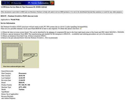

Need a special interposer for POD on that machine, IBM designed the board before Intel made the last minute change to specs, so it doesn't work right. Though we've seen someone try it without, basically went "It works perfectly apart from all the things it can't run and the times it crashes and locks up."
edit: horses mouth version ... http://ps-2.kev009.com/pcpartnerinfo/ctstips/fbee.htm

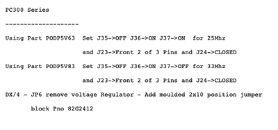

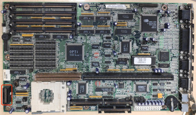

Reply 29 of 35, by Irinikus
BitWrangler wrote on 2024-02-09, 18:16:

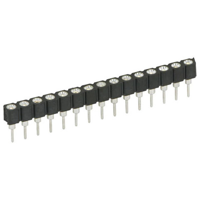

That interposer would be pretty much impossible to obtain today, but there is this risky workaround: (Removing a pin from the Pentium Overdrive chip)
151.56 KiB
460 views
However, you could mount the chip using tulip connectors, and omit the one that would be slotted onto the pin that must be removed. (A much less risky approach!)

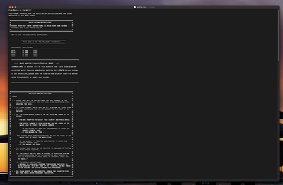

Ive also managed to download a copy of the LEJT67A BIOS update that's required

I'd also have to remove the VRM and insert a jumper block:
1.27 MiB
434 views
And set the following jumpers:
31.03 KiB
432 views

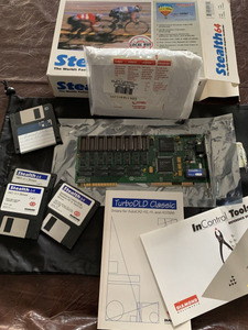

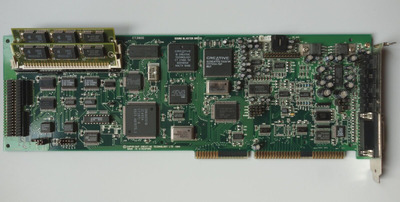

Reply 30 of 35, by Irinikus
CoffeeOne wrote on 2024-02-09, 18:14:
1024x768 true colour? Really?
Then you need the 4MB variant of the Stealth 64, I think.
Absolutely! I also think that I'll need the 4MB variant. (I'll have to purchase one of these and fill the empty RAM sockets)
269.11 KiB
385 views
So the other 2 cards will be a NIC (or how do you want to transfer data?) and a sound card.
I've had a think about things and I'd like to have this machine running Windows 98 and DOS. (Its already running Windows 98)
Therefor rather than installing a NIC I'd rather make use of an AWE32 (CT3900) for windows
201.56 KiB
389 views
and a Gravis Ultrasound Max for DOS
364.38 KiB
389 views

Reply 31 of 35, by CoffeeOne
Irinikus wrote on 2024-02-10, 16:30:
Absolutely! I also think that I'll need the 4MB variant. (I'll have to purchase one of these and fill the empty RAM sockets) […]

Reply 32 of 35, by Shponglefan
Therefor rather than installing a NIC I'd rather make use of an AWE32 (CT3900) for windows […]
You'll likely want to use both those sound cards with DOS, since other than the GUS Extreme, Gravis Ultrasound cards don't have great SB compatibility.

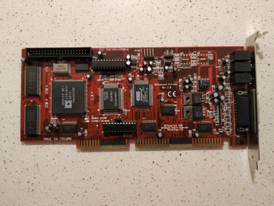

In this case, this would be the GUS to go for: (The Viper Max, "Extreme")
314.62 KiB
310 views
This covers all of the classic versions. I already have a GUS PnP, version 3.0 which is going into my Dual Pentium Pro build, but it's a different card all together.

Reply 34 of 35, by Shponglefan
Irinikus wrote on 2024-02-11, 06:38:
Thanks for the input! :) […]
Shponglefan wrote on 2024-02-10, 21:32:
Thanks for the input! 😀
You can't go wrong with a GUS Extreme. It does pair nicely with an AWE32 (or AWE64) in DOS, since then you get SB Pro, SB16, AWE32 and GUS support. And with a CT3900, you'll have two FM synth options: Yamaha OPL3 via the CT3900 and ESFM via the ESS chip on the GUS Extreme.
I did something similar with my 1996 Pentium and Pentium Pro builds as detailed in this thread. Installing drivers was a bit of challenge; I found starting with the AWE drivers first (at default settings) worked best.
Pentium 4 Multi-OS Build
486 DX-33 with 5 sound cards
