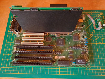

Recently I obtained another nice specimen made by the Digital Equipment Corporation. At first I expected it to be the guts of a Prioris XL 5200 server (https://theretroweb.com/motherboards/s/dec-prioris-xl). Now I have doubts about this. My board looks very similar to that of the XL 5200, but there are some differences. My board has 4 black ISA slots whilst the XL 5200 has 5 brown ISA slots and maybe the are more differences which I might not know of yet.

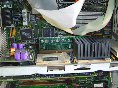

XL 5200:
81.73 KiB
294 views
https://mastodonpc.tripod.com/personal/5200-p.html

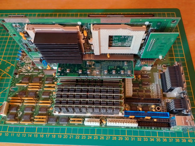

My board:
1.73 MiB
294 views

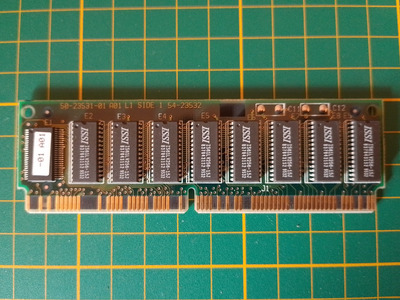

It came with a dual socket 5 processor complex with furthermore one Pentium 133MHz cpu, a cache module (COAST), a little break-out board and a power supply.

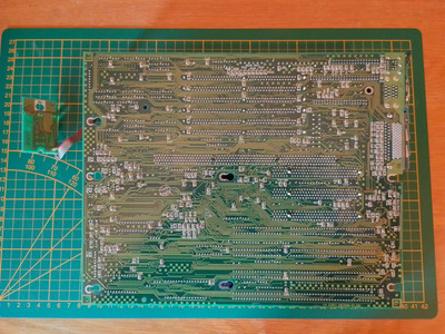

Some more photos to help:

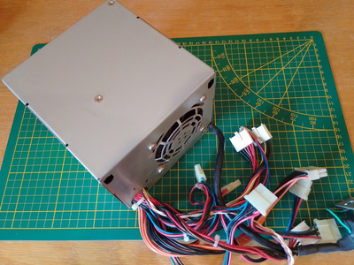

I'd like to hook the board up to the power supply, but I don't know in which order it has to be connected. The connectors are not keyed (anymore?) so without knowing to put which connector where is like playing Russian roulette.

Overview photos:

wrt the psu connectors similar to the P8,P9 and whatever that third one is called, take a multimeter and the ISA & PCI pinout and measure which pin goes to which voltage pin on the isa & pci slots.

Interesting that the board is 4 layer, but Cache module 6 layers 😮 and they stuffed all SRAMs on one side.
its Celebris XL-5100 Digital equipment's celebris XL 5100 has black screen and gives out an error code. last post includes documentation, those are on the spare parts list
54-23532-01 54-23532-01 Module, 256K Asynchronous Cache
54-24070-06 54-24070-06 P54C-100 CPU Card w/0 CPU
theretroweb entry is wrong listing it as 440FX https://theretroweb.com/motherboards/s/dec-ce … ebris-xl,-xl-dp the board itself doesnt have a chipset 😀 chipsets are on CPU cards

So this is why the weird PSU, why everything CPU-specific is on the CPU card, and why some of the stuff about it on TRW mentions Alpha AXP. The Celebris XL service manual doesn't mention that ATX-looking connector at all and so presumably doesn't use it, but the Alpha XL manual says its all 3.3v - I guess for the Alpha CPU (other Alpha workstations of around that age also have a pile of extra 3.3V from the PSU).
