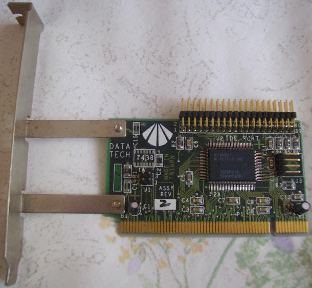

Reply 86 of 100, by retro games 100
Regarding PCI controller cards, I got this ancient looking thing off ebay. (No one else was interested. 🤣 ) I've not had a chance to test it yet, but I'm hoping I might get lucky, and it'll work on a suitably ancient mobo such as a 486. I think it's worth a try.

Reply 87 of 100, by swaaye
I've had luck with Promise Ultra66 on 486 PCI mobos. You can't run a CDROM on them though.

Reply 89 of 100, by Amigaz
PS - just wanna thank everyone for replying to my posts in the past - I haven't been replying with "thanks" to them all recently, because it doesn't add anything to the topic.
Got one these two but with two IDE channels..it was on a socket 5 mobo I bought which lacked onboard I/O completely
Please let us know if it's any good since I want to use mine on an 486 mobo 😀

Reply 90 of 100, by retro games 100

Reply 96 of 100, by retro games 100
Miserable failure I'm afraid. I tried the card featured in the photo, and another similar ancient card with 2 IDE connectors on it. I tried to get it to work about 30 times. Unfortunately, I don't know what I'm doing inside the BIOS, when it comes to getting a PCI IDE card to work. Do I choose ESDI, SCSI, HDD auto detect, PCI card auto slot or slot x, edge or level, etc etc. I tried faffing about with whatever options I thought might work, but nothing worked.
Interestingly, there's a date on the back of the PCI IDE card featured in the photo. It is 22/03/94. The mobo I am testing it on (SYL8884PCI - EIO) must have been approx of that era.
Reply 97 of 100, by retro games 100
Miserable failure update: I tried the above featured controller card in a socket 7 mobo. After much failure, I decided to take a gamble, and stick on some jumper caps on to the open jumpers on the card. Interesting - the BIOS auto detect HDD mechanism now "sees" the HDD. So far, so good. But unfortunately, the mobo won't boot up with the HDD. My POST test card reports "initialize HD controller" error, before the mobo displays a similar HD failure message on the monitor.
I tried lots of BIOS options - boot up with C: drive or SCSI, select Edge or Level, PCI IDE slot auto or slot X (I tried PCI slot 2), ...
And the good news? I've got another ancient looking IDE PCI controller card, this time it has 2 IDE ports. That worked like a charm. But really, who cares? The principal object in this lesson was to get these things working on 486s. After all, the Epox socket 7 mobo that I am using to test these things on has very nice integrated IDE ports, which successfully allow me to slave a CD-ROM from the master HDD.

Reply 99 of 100, by 5u3
Late reply because I've been on vacation, but here we go...
@ retro games 100:
Sorry to hear that your attempts with various add-on IDE controllers didn't work out as expected.
Getting these to function properly on old mainboards is difficult indeed: Modern PCI IDE controllers rely on advanced PCI features (like busmastering), which don't work correctly on old mainboards. On the other hand, old IDE controller cards are exactly the same crap as old onboard controllers.
I use my onboard controller, because don't have the nerve to deal with PCI controller-related problems (and I don't have space left for another PCI card).
486-era onboard controllers have their disadvantages (size limitations, low speed, can't boot from CD-ROM), but at least they work "out of the box", without much configuration hassle.
In my opinion, CF cards are ideal for old integrated IDE controllers: You can get them in sizes to match the size limits, i.e: 512 MB for the 1024 cylinder barrier, 8 GB for the Int13 barrier, etc... The tricky part is to find out what the size limit is on your board. 😉
