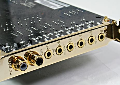

I currently own an Asus Xonar D2X as my soundcard. I use this to output to a surround sound speaker system. Here's an image of its inputs:

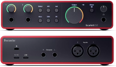

I also own a Focusrite Scarlett 2i2. I use this as an input for a condenser microphone to record in high quality, and I use it to output to headphones. Here's an image of its inputs:

What I would do is get an rca to xlr cable like this https://www.amazon.com/dp/B07SHWYDVQ/ and feed it into the rear of your 2i2, leaving the front inputs for your microphone, but its not ideal because it wants a mic level in, not a line level in.

The sc-55's output should not be treated as a mic, it's line level. Run it to the line in on the Asus.
Reply 3 of 8, by BloodyCactus
i just realised the cables i reccomended wont work with the mic because its only 2 inputs.... i was thinking like the 4i4 or something... so yeah running into the xonars line in is much better with an rca to trs such as https://www.amazon.com/dp/B01D5H8LDM/
personally if your gonna add stuff... a mixer would be better.

Hi Oetker, thanks for responding! I am a bit concerned about that, since I would assume that the display should show changes, but that is not the case. The USB indicator light does flash, though. I assumed that the SC-55 would display activity on its screen despite not outputting sound (or perhaps more specifically, myself not being able to hear the sound). Regardless, once I know that the audio can work with what I physically have, I'll tackle that challenge.

Thanks a lot, BloodyCactus! I'm interested in what you were originally trying to suggest, though. Would the Scarlett 4i4 work as well? Are you specifically looking at the inputs 3 and 4 in its rear side, which mine lacks? How do you suppose that would look, then?
My Asus Xonar can record its output directly, which is pretty cool and I hope that that could be a solution for recording the MIDI side of things, but there would be a benefit (I presume) if I had the option of outputting to my headphones if I were to replace the Scarlett with the 4i4 as well.

RCA cables connected to the "OUTPUT" on the rear of the SC-55 which connect to my soundcard (Asus Xonar D2X)'s Line In port through 3.5mm.
