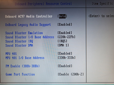

Problem:
I want to play some old DOS games also and according to various threads in this forum it should work with the SBPro Emulation and I have problems with the configuration, due to my poor skills about hardware from that time . I already read different threads in this forum but nothing works for me.
NOTE: I want to boot from a modified Windows 98 Start Disk and play DOS games from there - so I can decide, depending on the game, what to load and keep memory usage as low as possible.
I'm using drivers from 68mu220a.zip but I also tried 68mu220b.zip and the VIAFMTSR from this site
AUTOEXEC.BAT
C:\VIAUDIO\VIAUDIO.COM
C:\VIAUDIO\VIAFMTSR.COM
SET Blaster=A220 I5 D1 P330
BIOS Configuration:
223.92 KiB
233 views
If I use this configuration the PC sticks at the VIAUDIO.COM line. If I disable the MPU 401 or use a different not matching address in the SET Blaster instead of P330 it gives me the "Congratulations" message, but without working sound. Auto detection of one game gives me a DMA: failed to identify, maybe this helps?

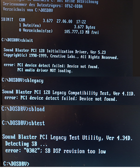

Reply 1 of 3, by chinny22
You could try the generic creative dos drivers, which can be found here.
http://vogonsdrivers.com/getfile.php?fileid=49&menustate=0
By default it lives in c:\dossrv so will not interfere with the VIA drivers if we need to go back to them.
Typically you would load
C:\DOSDRV\SBLOAD.exe
C:\DOSDRV\SBINIT.COM
but you also have a few other exe's to play around and test with.

I have tried a lot of combinations, but still silence....
For the generic creative dos drivers:
251.58 KiB
111 views

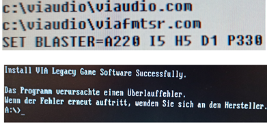

Viaudio + Viafmtsr:
Viaudio shows: Install .... Successfully
Viafmtsr:
(*) sometimes crashes
(*) sometimes shows an overflow error
(*) sometimes looks like to succeed, but still no working sound
112.65 KiB
111 views

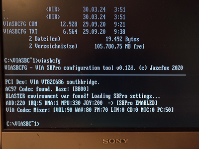

I have tried the tool from VIASBCFG - VIA SBPro configuration tool for VIA VT8231 & VT82C686/A/B chipsets (v0.12d) and the output is as follows:
244.17 KiB
111 views
But there is still no sound. Maybe somebody has an idea what else I can try. Thank you very much!
