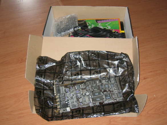

Hey they even sell such a Maestro 32 card in my small country.. If I am correct.. cool!
(Edit: this is the second Windows 95 PNP adapted release from 1996, with 'Dream' chipset? I hope it doesn't cripple the card too much.... )
usually they sell soundblaster variants, and when I look op their ct numbers on the internet they always appear to be soundblaster cards that one should not want.
But I might just buy this card then, it's cheap anyways.
(Currently I don't have any ISA sound card... There was one removable isa SB compatible card in my first PC (1994?), When I bought it it was bundled with two of the tinyest speakers one can find, in my memory the card was awesome. But I was a hardware noob then, and the PC was sold, so I will never know what card it was... ) 🙁

Marek, I suppose the card on the picture above isn't your card, right? The card above is a Maestro 32/96 (pnp). And so I was wrong, when I said I've the same card like you, I have the one above (32/96) with the synth on the board. Maestro 32 instead should be a Terratec "Soundsystem Gold 16" with a DREAM wavetable daughterboard on it (please correct me if I' wrong). Has it an ESS or a Crystal codec?
