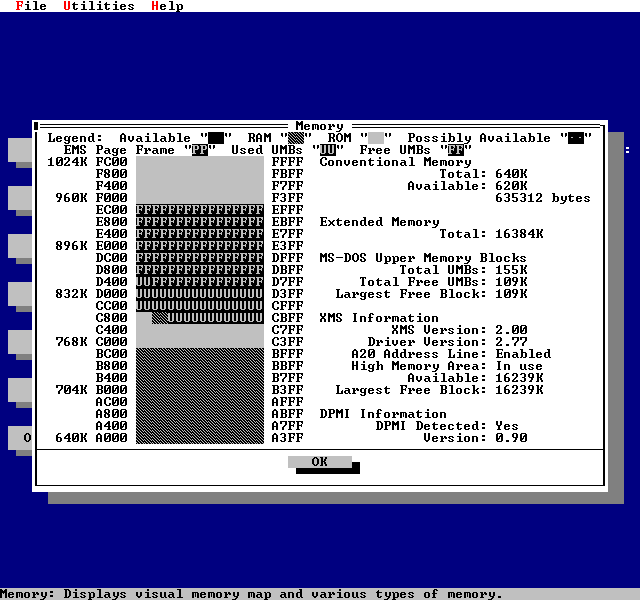

Weeeell, here's my MSD memory information.
Just as a note, you can't really use the "default" LaunchPad setting or it won't come out like this -- you have to enable VESA... but leave everything else the same.

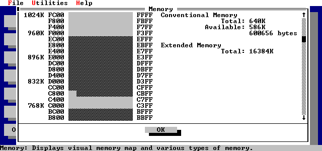

Screw VESA; just go to the window's propertes and make it 50 rows high.
I disabled EMS and I got this (it's all "free"):

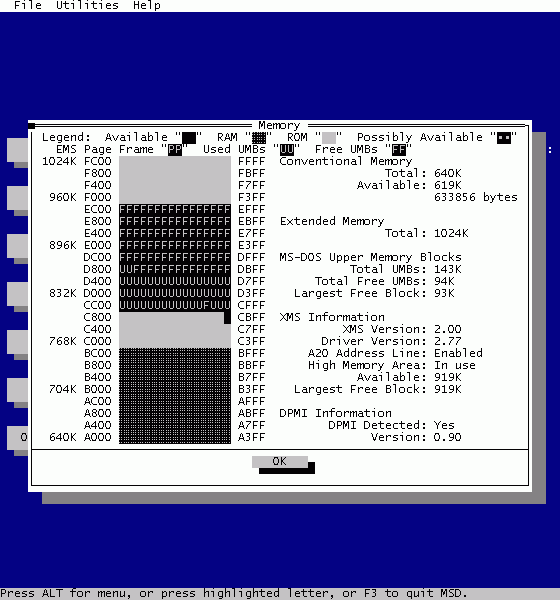

OK, just disabling "dos=UMB" (UMB from LaunchPad) doesn't make a difference (still shows up as ...FFFFFF..., i.e. free UMBs, although DOS won't use them for LH). I also have to disable HIMEM.SYS to see a difference (see below):
