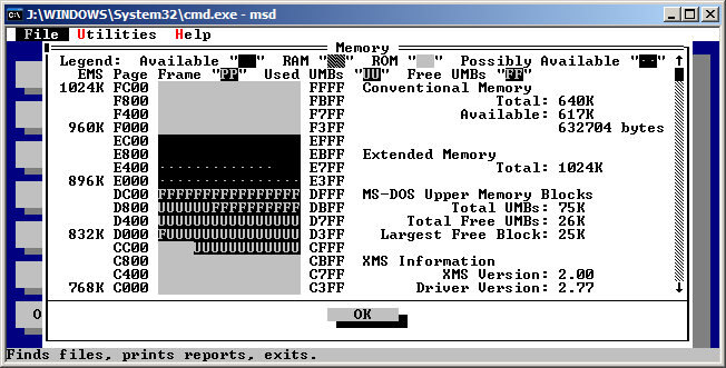

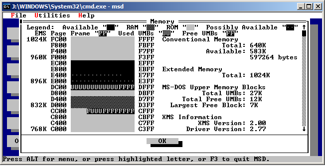

Reply 82 of 117, by DosFreak
Fixed my EMS!
Was looking through MSD and saw that Address D800 was being used by my HPT 372A.
So I disabled the HPT372A and EMS still did not work....
I then disabled my on-board USB + HPT372A and it worked!
These are the addresses that EMS was using:
Page Frame: D000H
DC00-DFFF
D800-DBFF
D400-D7FF
D000-D3FF
I then enabled RAID but disabled USB and noticed that RAID ate up this address range:
D800-DBFF
I then DISABLED RAID and ENABLED USB:
I was unable to determine the address range as easily...still to be determined.
Most likely D400-D7FF and D000-D3FF
After verifying all of this in DOS I then booted into NT and EMS worked in NT too! YAY!
Here are the BEFORE & AFTER pics taken using MSD under Windows XP NTVDM:
As you can see....
DC00-DFFF on BEFORE is being used by some UMB's. Only 4 spaces are available
but on AFTER the whole range is free.
D800-DBFF on BEFORE is taken up by ROM's. That's the HPT372A
D800-DBFF on AFTER is used and free....
D400-D7FF on BEFORE is RAM
D400-D7FF on AFTER is used UMB
D000-D3FF on BEFORE is RAM
D000-D3FF on AFTER is used and free
Weird, weird weird.
I KNOW for a fact that D800-DBFF is used by my HPT372A because MSD say's so in both DOS and WINDOWS in the memory browser. (Use Utilities and click on the Memory Browser). It actually say's HPT372A! When I disable it & USB, EMS pops back up! But when you go into NT it shows it as "RAM" instead of being "Used"...Does "RAM" mean "used" memory? Must be.....
Well that's the solution in my case. Could be any number of different hardware in other cases but most likely not too many. Going to email ABIT this week and see what's up because my KR7A worked with EMS USB/HPT enabled. I'm betting they knew what they were doing when they assigned those memory ranges tho. EMS isn't needed anymore so why worry about compatibility with ancient DOS games? Unfortunately there isn't a suitable program to take over the task of emulating EMS + whatever else a specific DOS program needs. Connectix Virtual PC is the closest but it's sound support absolutely SUCKS!
I'm definetly lookin' forward to 386+ support in DosBox! 😉
