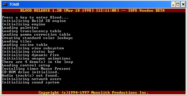

I take it that this pic is explains what a few of use are experiencing ?
I've sent Paul my copy of Blood, so hopefully (When the poor chap gets some time 😉 ) He'll have a look at it.
It's definately nothing to do with resolutions, as I've tried every combination possible.
Can anybody confirm that this version of blood has these problems used with GLidos, but works okay with a real voodoo card? It looks like the game is plotting the wrong triangles.
A test with a voodoo card would want to use my blood.bat so as to get the same BUILD_XXXX settings.

Anyway I'd still like to get the mouse buttons working in Blood.
They *do* work, are you talking about in general, Paul ?
Look at this screen from the SETMAIN.EXE, then "Setup Mouse".
