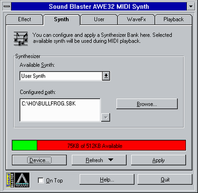

Reply 55 of 79, by aybe
Thanks for this fantastic program !
I'd like to share with you a little trick I just found out while trying to play Hi-Octane music for AWE32:
(maybe some of you already knew it, anyway)
Since the game uses ROM samples, the playback is incorrect unless they're uploaded to the card, but there's no such feature in PX.
So while playing with the AWE32 installation CD, I found the AWE32 Control Panel, which allows to upload SBKs to the card.
Make sure that you upload it to the card from the 'Synth' tab, because doing so from the 'User' tab requires MIDI CC messages to be sent for the card to switch to the correct bank:
(this is the utility running in Windows 3.1)
12.12 KiB
1489 views
Now PX plays the music exactly the way it should be 😀
(I believe the same trick could be applied for other brands of audio cards, providing they have the same sort of utility)
