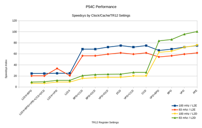

Just a generic flat top P54C. I don't think I even looked at what the stock multiplier was as I was mainly interested in approaching 286 performance if possible.
Anyway, I was somewhat underwhelmed. Lots of flags didn't have an appreciable effect. It just didn't seem as versatile as a PMMX.

Reply 147 of 228, by appiah4
gdjacobs wrote:
Just a generic flat top P54C. I don't think I even looked at what the stock multiplier was as I was mainly interested in approac […]
appiah4 wrote:
That's very interesting, care to let me know which ones did not work?
Interesting. The legend may be wrong? 83MHz L2D is faster than everything else when PFE is used, is the data mislabeled?
Reply 148 of 228, by gdjacobs
Yup, I think 83mhz and 100mhz are reversed for the L2D series. It's a graph I threw together from one year old data, so there's probably other clerical glitches in there. Even more strange, look at the performance between the L2D and L2E series with caches enabled. L2 cache actually slows down the chip here.
My point was the much more horizontal trend of the P54 wrt TR12 parameters in comparison to my PMMX. Notice on the PMMX how the CCD and DCD flags have a differing performance impact with L2 enabled and serve to fill gaps in the performance range. That's not nearly the case with the P54.

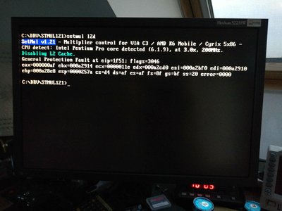

First a big Thank You for this cool utility!
I have an issue on my Pentium Pro build:
244.74 KiB
1240 views
setmul121 L2D on PentiumPro in real mode (no EMM386 etc.)
It is the same if I have loaded EMM386 or if I don't load any driver (F5 at DOS startup). What could I do?
Disabling and re-enabling L1 cache works. Is it correct that it always disables (enables) the L2 as well?

Thanks for the information.
I have to look up the intel Pentium Pro and Pentium II/III datasheet again regarding the L2 cache functions. But since I don't have access to a Pentium Pro system, this will most likely end up with me disabling the L2 cache function on Pentium Pro CPU's, since in practice it does not work.
