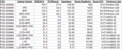

I've got a very special (to me) CPU. I don't know if all POD 200MMXs are like this, but all of the TR switches work on mine. I think I've worked out all the combinations:
27.86 KiB
1761 views
Because my motherboard does not have any L2, this makes the TR switches exceptionally useful.
On my Pentium 120, CCD and DCD to not have any effect, which takes all 486 performance levels out of the equation.

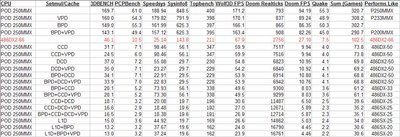

I moved my POD200MMX into a SS7 motherboard which let me overclock it to 83x3=250Mhz. Here is a new speed profile. One thing I noticed in this retest is that Ultima 7: The Black Gate, which is well-known to be immune to disabling L1 cache, is NOT immune to the test registers BPD (branch prediction), CCD (L1 code cache), DCD (L1 data cache), and VPD (V Pipeline). So if your CPU supports the test registers, you can disable combinations of these to get Ultima 7 to a playable speed! I wrongly assumed previously that CCD+DCD is equivalent to L1D, which proved out wrong when I ran the game with "setmul L1D" and watched it run at full speed. On my system, U7 played perfectly with the setmul switches CCD+DCD (which I give a "Performs Like" rating of 486DX-25).
I also threw in results for my real 486DX2-66 for reference. Lastly, I ranked the results by the sum of the real game benchmarks of Wolfenstein 3D, Doom, and Quake, then rated each speed zone as a ratio of the real DX2-66 game sums.
Notably, many of the synthetic benchmark results vary wildly with different combinations of these test registers.
The slowest result on the chart plays Wing Commander I too fast with few enemies on screen, and with a screenful of enemies it *almost* plays at perfect speed, still a bit too fast. So that seems to jive with the "Performs Like" rating of 486SX-20.
135.67 KiB
1361 views
