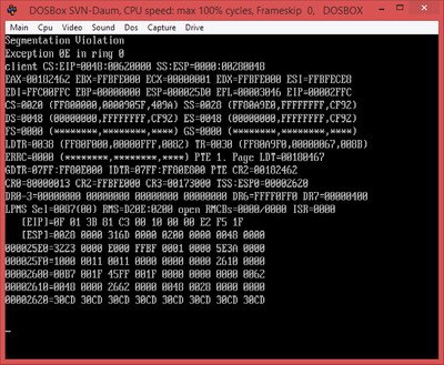

Have a question - does Ctrl+4 crash MBF for anyone running it on real HW?
The reason I ask is because the version of DOXBox I currently run (not using the sig rig, unfortunately) consistently crashes Tartar, MBF 2.04 and @crvs's build, and pressing Ctrl+1 - Ctrl+9 visibly slows the game down.
I am suspecting either Allegro or DJGPP malfunction, as the keyboard handler func does not seem to get the scancode event for the Ctrl+4 keypres.
Here's the @crvs's buid's output, as it looks to be most useful of the bunch:

Reply 268 of 281, by leileilol
ludicrous_peridot wrote on 2023-01-07, 20:26:
These are CPU emulation core-switching hotkeys in Daum. Your crash is caused by switching to the simple core while running a protected mode game.

Reply 269 of 281, by dr_st
Yes, to repeat what is said here every time someone brings it up - please stop using DOSBox SVN-Daum. It has not been maintained in ~8 years, and the last couple of builds were buggy and broken in various ways.
