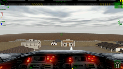

285.21 KiB
16517 views
1600x1200

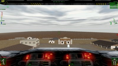

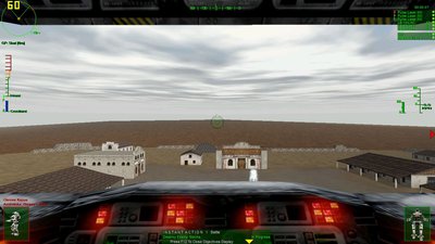

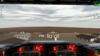

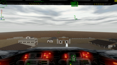

Found a way to insert custom resolutions. Even widescreen is possible. However Mech3 is pretty picky about what resolutions it accepts, so far I haven't determined the logic behind this. Also the Hud doesn't scale properly.
1440x900
268.67 KiB
16478 views
1680x1050
332.13 KiB
16467 views
Edit: Widescreen patch.
Mech3_HiRes4.zip
4.37 KiB
1107 downloads
1152 x 864 replaced with 1440 x 900 and 1280 x 1024 replaced with 1680 x 1050

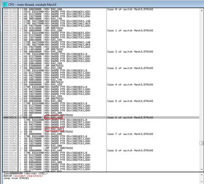

beatcracker wrote:
Is there any way to go beyond 1600x1200? Would be nice to run it at any arbitarty resolution.
I couldn't get any of the resolution bigger than 1600x1200 that I tried to work but that doesn't mean there aren't any.

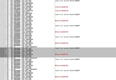

In case anyone wants to give it a try here's a howto:
You need Ollydebug
http://www.ollydbg.de/version2.html
and the Windows Calculator.
Launch Ollydbg and open Mech3.exe
Click on View->Executable Modules and select Mech3.exe (it should be right at the top)
Select the "CPU -Main thread" Window and scroll to the top
Rightclick in the Window and use
Search for->Command to find mov ecx, 640h
If you scroll up a little bit should see this
161.83 KiB
16345 views
That's a list of all resolutions currently available in the game
Case 8 for instance shows 1152x864 in hex form
360 (hex) = 864 (decimal)
480 (hex) = 1152 (decimal)
Each resolution is listed 3 times
You can easily convert decimal and hex values with your Windows Calculator. Press Alt+3 to switch to programmer view, with "Dec" at the left selected enter a decimal value and click on "Hex" to convert to hex.
For example if you want to replace 1152x864 with 1440x900 first convert 1440 and 900 to hex form.
900 = 384 (hex)
1440 = 5A0 (hex)
Then rightclick on MOV EDX,360 ->Assemble to replace it with MOV EDX,384
and then replace
MOV ECX,480 with MOV ECX,5A0
You have to do this 3 times each.
After that do a search for MOV EAX,480 and MOV EAX,360 to replace those as well.
227.22 KiB
16345 views
To finalize the changes do another rightclick and select Edit->Copy all modifications to executable.
A new window will open. Rightclick on it and choose Save File... .

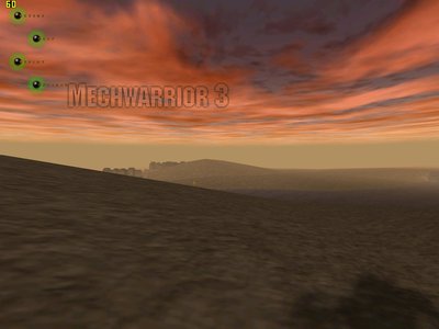

WIP
    771.6 KiB
    16004 views
    635.99 KiB
    16004 views

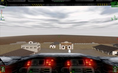

Reply 6 of 75, by teleguy

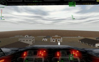

WIP
1280x720
123.5 KiB
15758 views
1600x900
165.14 KiB
15758 views
1920x1080
207.51 KiB
15758 views
2560x1440
298.31 KiB
15758 views

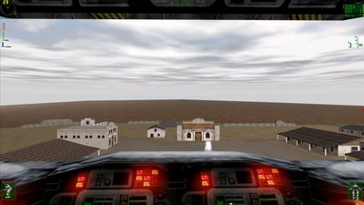

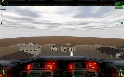

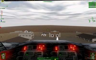

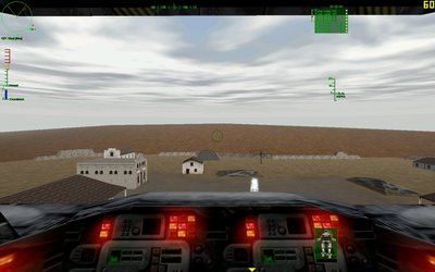

Reply 7 of 75, by teleguy
WIP
1440x900
141.28 KiB
15752 views
1680x1050
170.39 KiB
15752 views
1920x1200
218.58 KiB
15752 views
