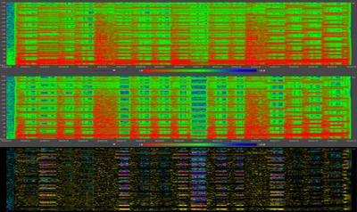

Reply 348 of 530, by ElBrunzy
I did a audio comparison of a SN76489 (left) and SAA1099 (right) recording using a tndy nano v1.0 card by matze79 that's built around an SN76489 and a soundblaster 1.5 with saa1099 addon. I used sbvgm.exe v1.33 by to play a list of music since it support both cards. I added a pause in between each track so I could re-sync the audio in between each track. Since I did not want to add mp3 compression artefact I saved a 44.1khz 16bit wave file. I wanted to make a new playlist but I could not find enough new music for it, so I re-used the one I made already with the addition of WonderBoy3. Maybe it will help us understand the audio problem with the bass note on some music. I think it is apparent in the phantasy star and y's music again, but I think you are aware of that problem and just need some time to address. Other than that I think the tone and timing resemblance is very convincing but there seem to be some amplitude difference in between some instruments so it's hard to balance stereo signal. Since the file is around 90mb I will put it on 💾 google drive.
Here is the lineup:
Alex Kidd in Miracle World - 04 - Underwater.vgm
Choplifter - 02 - Round 1.vgm
Gunstar Heroes (GG) - 04 - Choose a Path.vgm
Gunstar Heroes (GG) - 08 - Rolling Chaser.vgm
Lord of the Sword - 04 - Story.vgm
Miracle Warriors - 04 - Castle.vgm
Phantasy Star - 15 - Medusa.vgm
SpellCaster - 05 - Forest.vgm
Wonder Boy - 04 - Boss Round.vgm
Ys - 05 - First Step Towards Wars.vgm
Wonder Boy III - 10 - The Danger Zone.vgm
While I had everything open I'll make a spectrograph of Ys since the bass problem seem to be more apparent here. Maybe it will eventually be of any help. It's a zoom of the first 2 seconds 0-4khz frequency of Ys with the SN76489 on top, SAA1099 in the middle and the difference in bottom. It look like where there is supposed to have a mute the bass line get to be played too loud... or something like it. I'm eager to have your opinion on that.
423.11 KiB
1584 views
Reply 349 of 530, by OPLx
@ElBrunzy, what you for making the recordings and looking further into the issue. The main cause of the incorrect bass sound on the SN76489 is that the Sega Master System implementation is different from that of the SN76489AN. At the time I added support for the SN76489, I did not have actual hardware and used DOSBox. Under DOSBox, you won't hear the issue with the bass notes so the SN76489 variant used by DOSBox is likely the Sega Master System version and not what is found on the Tandy 1000 or SN76489AN. Fortunately, there are some SN76489 flags in the VGM data that can be checked and thus it will be possible to correct for the behavior which is in this case, silencing the note.
Fixing this is not difficult; it's more of an issue of having a sufficient block of time which at present, is lacking on my end.
Reply 350 of 530, by ElBrunzy
Hi OPLx, I hope I did not stressed you with that issue, I know is must be the third time I bring it to your attention. Having an hobby can become a burden if you feel an obligation to work on it and it's not what I'm trying to achieve. On the opposite, I was in the impression that to document the problem would allow to securely postpone the fix.
From wikipedia and smspower we can read that the "AN" designate the packaging and the presence of an audio in. They also say that sega used the AN in sg-1000 and sc-3000 but used a clone in the VDP chip. Although on a seemingly more complete documentation we can read that "Up to 4 MHz Clock input: Part SN76489N is identical to the SN76489A except that the maximum clock input frequency is 500 kHz. A "divide by eight" stage is deleted from the input circuitry and only 4 clock pulses are required to load the data, compared to 32 pulses from the SN76489AN."... oh well I'm not sure what to make of all that.
I did try to play the problematic musics lowering the speed on my own "player" (if you call your player an experimentation, then we should call mine a bunch of code line thrown together that luckily work) and what I noticed is those loud bass notes always appear when a 0x00 value is from the 0x50 instruction. Resetting the PSG at this moment (sending 0x9f, 0xbf, 0xdf, 0xff) did not help, I seem to remember some test related to that from you. the sn76489an dont seem to like receiving that 0x00 instruction, but on another hand stripping it from the stream dont seem to be the solution either.
Reply 351 of 530, by OPLx

Reply 352 of 530, by OPLx
SBVGM v1.34 is available from: http://www.oplx.com/code/
This update includes the fix for the SN74689 'low bass note' issue that occurs with Sega Master System VGM's that use a frequency value of 0 to 'silence' the note which was reported by @ElBrunzy.
