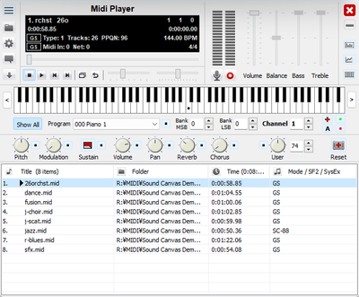

Reply 1478 of 1508, by basic
I found other issue about a 32ch MIDI file, '26orchst.mid' from SC-8820 demo files.
This doesn't work 32ch with current version of FSMP.
But I found this midi works 32ch correctly with an another MIDI player supports 2-port, It's Miyap2002.
This player supports RCP/R36/G18/G36 with GSD/CM6, RCP/R36/G18/G36 is another MIDI format those was created with PC-98.
I hope FSMP can detect 26orchst.mid to 32ch mode, and similar types too.
Reply 1479 of 1508, by Falcosoft
basic wrote on 2023-07-23, 14:25:
I found other issue about a 32ch MIDI file, '26orchst.mid' from SC-8820 demo files. This doesn't work 32ch with current version […]
OK, I have added support for these types of port select markers. Unfortunately they are simple text events with the format 'Axx' and Bxx' where xx is the channel number and A/B designate the port. So in this case the chances of false positives are higher than in case of previous markers.
Please, test it and report back:
https://falcosoft.hu/midiplayer_62_test.zip
Website, Facebook, Youtube
