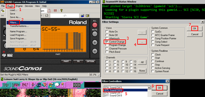

MAN-biker and me had a conversation about this problem:
MAN-biker: Hi. Help me understand what happens, please. When i try to play "Leisure Suit Larry 6" game in SCUMMVM, using SCVA as […]
MAN-biker:
Hi.
When i try to play "Leisure Suit Larry 6" game in SCUMMVM, using SCVA as MIDI, I have "cutted" notes!
There is no this bug if i use, for example, internal windows GS emulator.
And there is no bug if i use DOSBox instead of SCUMM VM.
Me:
Ok, I think I have found the problem. ScummVM/Larry6 sets CC#75 to 0 on all channels. This controller is undefined in GM, but on GS devices it controls 'decay time' and its default is 64. So you should filter Controller 75 or set it to default 64 after larry/scummvm sets it to 0.
If you use FSMP:
1. Enable Main menu-> compatibility settings->'apply controls to midi in'
2. Select channel 10.
3. Set the 'User' controller number to 75.
4. Set it to 64, or press a reset.
5. Press the little 'force manul mode' button beside the 'User' controller.
6. Repeat 2-5 on all channels where you experience this cutoff effect.
Overall: On later GS devices (e.g. SC-8820/8850 and SC-VA) the Controllers 75-78 are defined ('Decay Time', 'Vibrato Rate', 'Vibrato Depth', 'Vibrato Delay')
and the default values for all these controllers are 64 (0x40h). Yet when ScummVM sends default controller values it sets these controller values to 0 on all channels. This can cause e.g. 'note cut off' bugs because of Controller 75 - Decay Time. For other GS or GM/XG devices where these controllers are not defined setting the values to 64 is just as harmless as setting them to 0. So there is no side effect and these controller's default values should be set to 64 (0x40h) instead of 0.
Edit:
This info can be useful for other software/Midi players as well. 😀 Man-biker wanted to send a bug report to ScummVM Issue Tracker, but I don't know if he did it.

Reply 492 of 1419, by lukeman3000
Interesting. Have you posted a bug report about this on the ScummVM forums? You should do so if not.
Do you know, is there a way to set this value to 64 if I'm using savi host for SCVA? Also, do the instructions you gave for FSMP also apply to Munt VSTi?
Reply 493 of 1419, by Falcosoft
Look at my edited post above.
Do you know, is there a way to set this value to 64 if I'm using savi host for SCVA? :
Man-biker has used it:
139.05 KiB
1039 views
Also, do the instructions you gave for FSMP also apply to Munt VSTi?:
I don't really understand what you exactly mean but:
1. Munt(Vsti) is not affected at all either in MT32 or GM mode. (These controllers are not defined).
2. Of course you can do similar controller modifications with FSMP when you set its output to Munt Vsti.
Website, Facebook, Youtube
