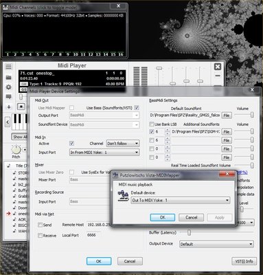

Reply 552 of 1727, by Falcosoft
Hi,
You said earlier that you had already used FSMP with DosBox. You have to use the same configuration with X-COM. You only need a virtual midi cable + FSMP. The game itself seems to use always the default Midi out port so you have to change the default midi out port of Windows to the virtual cable. Unfortunately It's not so simple under Vista/7/8/10. You have to use some 3rd party tools to do this. You can try Coolsoft Midi Mapper but if you do not want to install anything you can also use portable ones (one of them is attached: simply unzip it somewhere and double click the cpl file. It works well with Win7).
PLWMidiMap.zip
27.08 KiB
231 downloads
midi mapper Vista+
235.2 KiB
2640 views

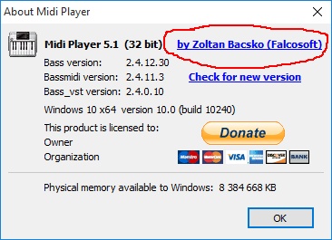

Reply 559 of 1727, by Falcosoft
Are you Zoltan on Youtube? Feels funny to have the same convo twice.
Yes, it's me:
41.47 KiB
2477 views
